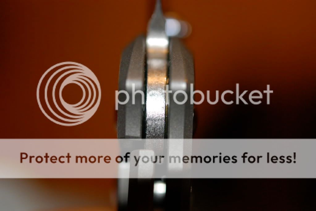

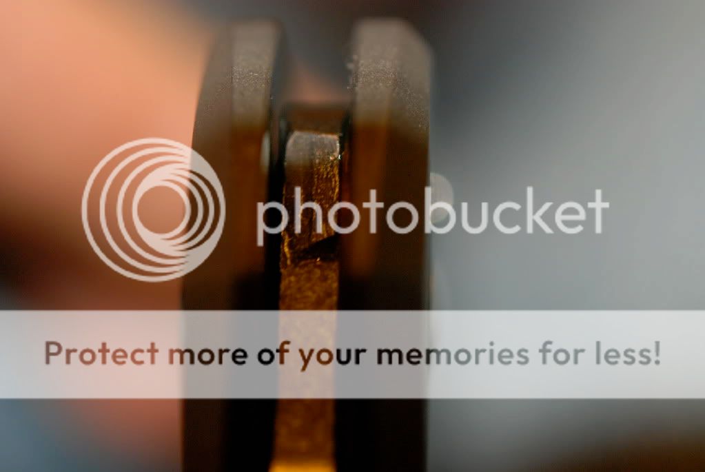

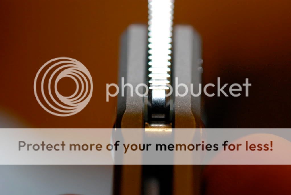

Heres the pics requested:

Can't see any gap
Hey Thalestin, is that rust in the last photo above there? On the stop pin? Looks red and slightly corroded to me. If it is, and there's also some on the side of the blade tang it could offset one side against a washer....
I am officially stumped. I do not see anything from the pics. I would call CRK on Monday and see what they say. I am sure that they will make it right. Sorry I could not help.

The second pic is how mine looked. It looks like the blade is hugging the right side, but the other pics seem to disprove this.

Nah, it is not rust, just a really crappy picture:) The flash made it look that way:)

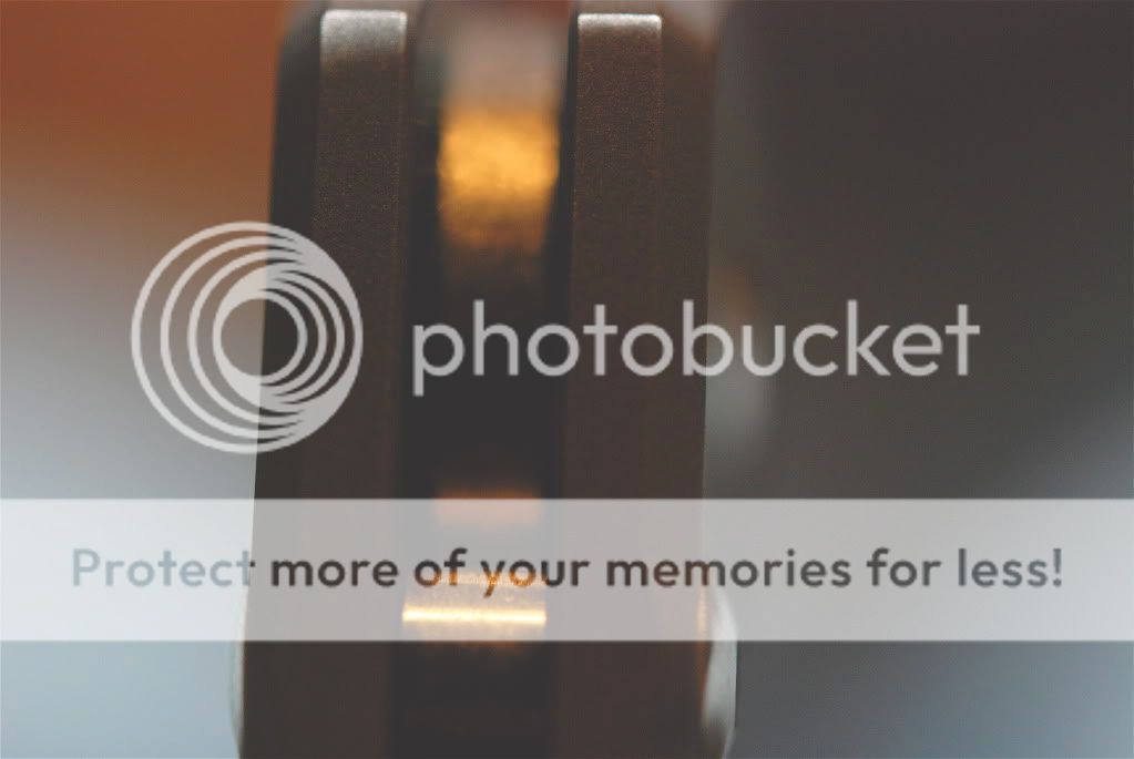

I'm not certain how to interpret this photo of yours. I cleaned it up a bit. It (almost) appears as if there's a crack in the blade and maybe... it's off a degree because of this... causing the off-centeredness when closed. Without seeing it up close I can only guess, and maybe ... mine is a bad guess. That's all I got.
heh, very interesting because I agree with you and must admit it looks like a little crack. In real though, it just has some oil on there and the flash made it look that way :) Just goes to show you cant trust pics much:)
