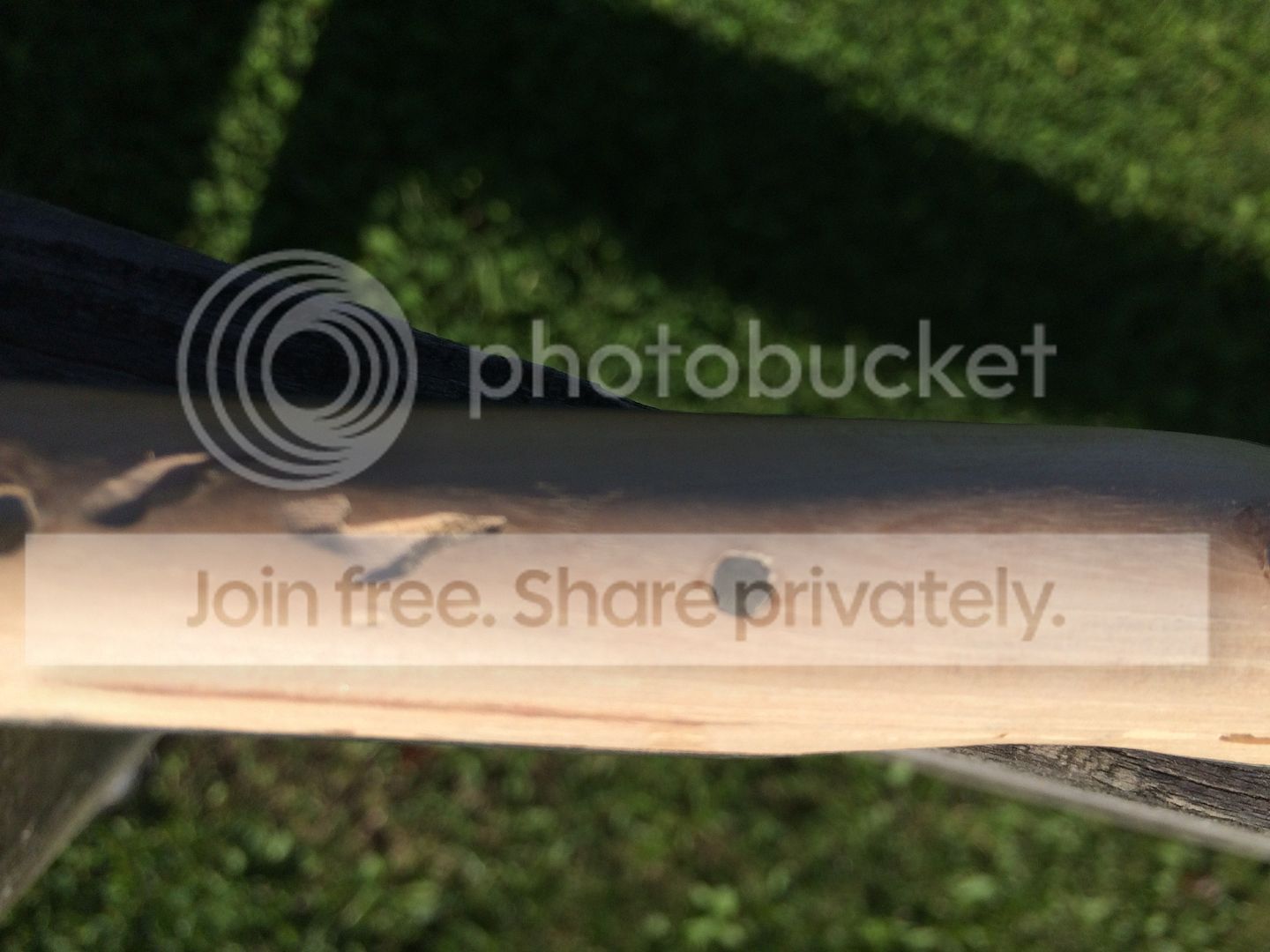

Several have done this to me - I start with a clean block of wood, do my normal cutting and shaping and gluing and then sand to shape. Then I start to find these pits in the wood below the surface. No way to spot them ahead of time before I do a bunch of work and I've now thrown away two sets of handles. Grrrrrr. (I also have been successful in making some handles from the same wood.) I'm working with a long dead tree limb a friend gave me. Is this natural for pecan, bug damage of some kind, or what??
Thank you.
Yep,best bet is to stabilize. Sometimes I fill the bug holes with contrasting dust and CA glue.
