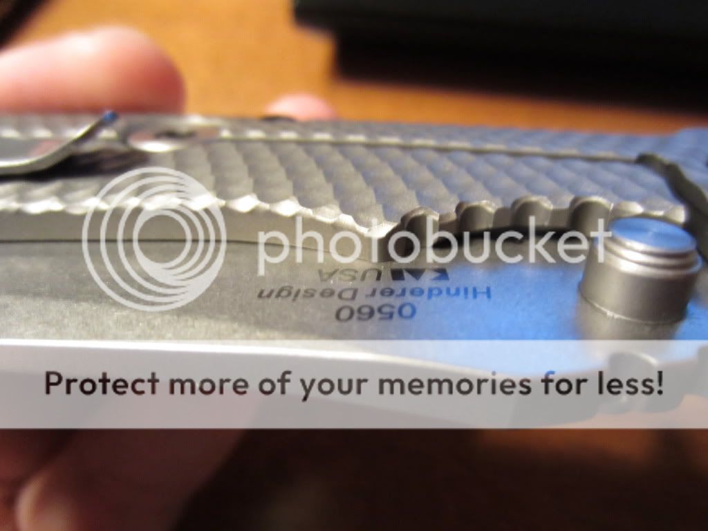

Just received my 560, and I'm having some problems. When actuating the flipper, the blade will not fully deploy. On top of that, the detent is so strong the blade will not deploy at all when trying to use the thumb studs. When working the blade open/closed, the detent squeaks. I've loosened the pivot, cleaned and lubed with Militec, and tried to flip it out many times to get it to break in. At this point the only way to deploy the blade is to hit the flipper and give it a good wrist flick. When it does deploy fully (20% of the time) it does so very slowly and barely locks up unless I add a backwards motion to it.
Can anyone offer any help with this?
TIA for you help.
Edit to add: The detent is making a clicking sound as the blade is opened. Normal?

my 561 has a VERY strong detent, but i like em that way.and there is also a click sound from the detent when i open it.But when it gets past the detent it Flies open.You might want to send it in doesnt sound right
I just grabbed mine out of the mailbox 5 minutes ago. I also experienced a tough time getting it to open. What I found was that my fingers were wrapping around and pressing the lockbar firmly into the blade, making the detent extremely tight. I found by bringing my fingertips off the lock bar it flips open with no problem.

It is, unless there is some debris or something in the bearings. If it were me, I'd take it apart and examine closer, but you can always send it in and KAI will take care of you.

After an audible click of the detent releasing, there is still quite a bit of restiance. Not gritty, but you can hear and feel the detent ball moving along the blade tang. From what I can see without pulling it apart, there is already quite a divot along the tang where the detent has bit in. It's almost like the detent doesn't have enough give? Hope that's descriptive enough.
EDIT to add: It's NOWHERE near as smooth as my 550. Night and day would not even come close to describing the difference. It's not gritty, but there is alot of restiance. More friction based than gritty. Almost like the pivot was over tight. Does that make a bit of sense?

One other thing I've noticed after carefully looking at it. When the blade is fully closed the lockbar comes to rest against the blade. Is that normal?
That's not right. Here's mine, close but not quite touching.

It kinda sound to me like the detent should have a little ball bearing that rides along the blade tang and maybe that ball is gone, so its Ti on steel and scraping along? Is there marks on the blade tang that show more than a little line of wear where the lock bar touches the blade?
Mine create a little etched circle concentric with the blade pivot. Something to check.
