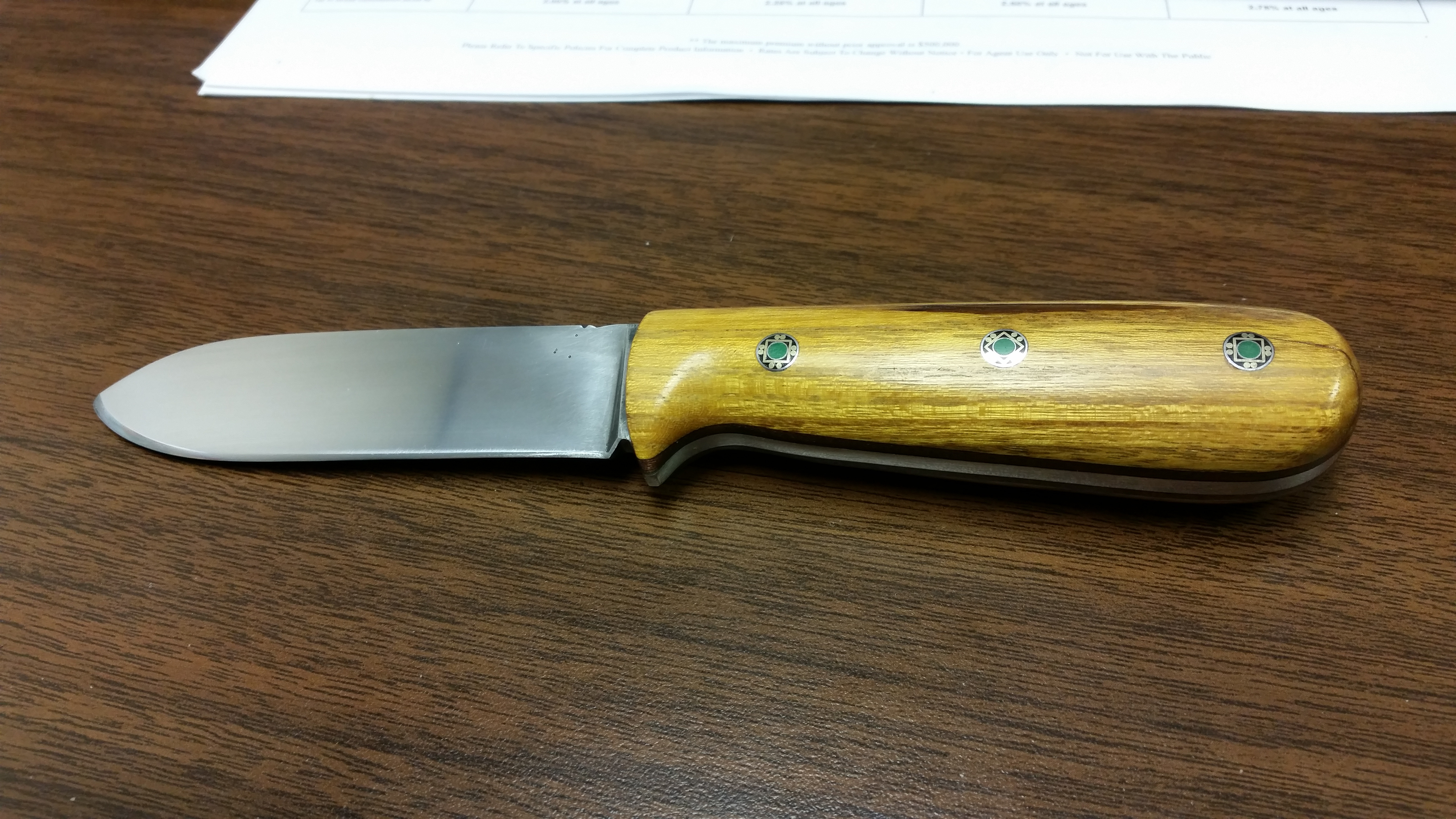

This is a Kephart knife I'm making for my uncle. Here's the blade as it stands. All that would be left is to etch my logo on it.

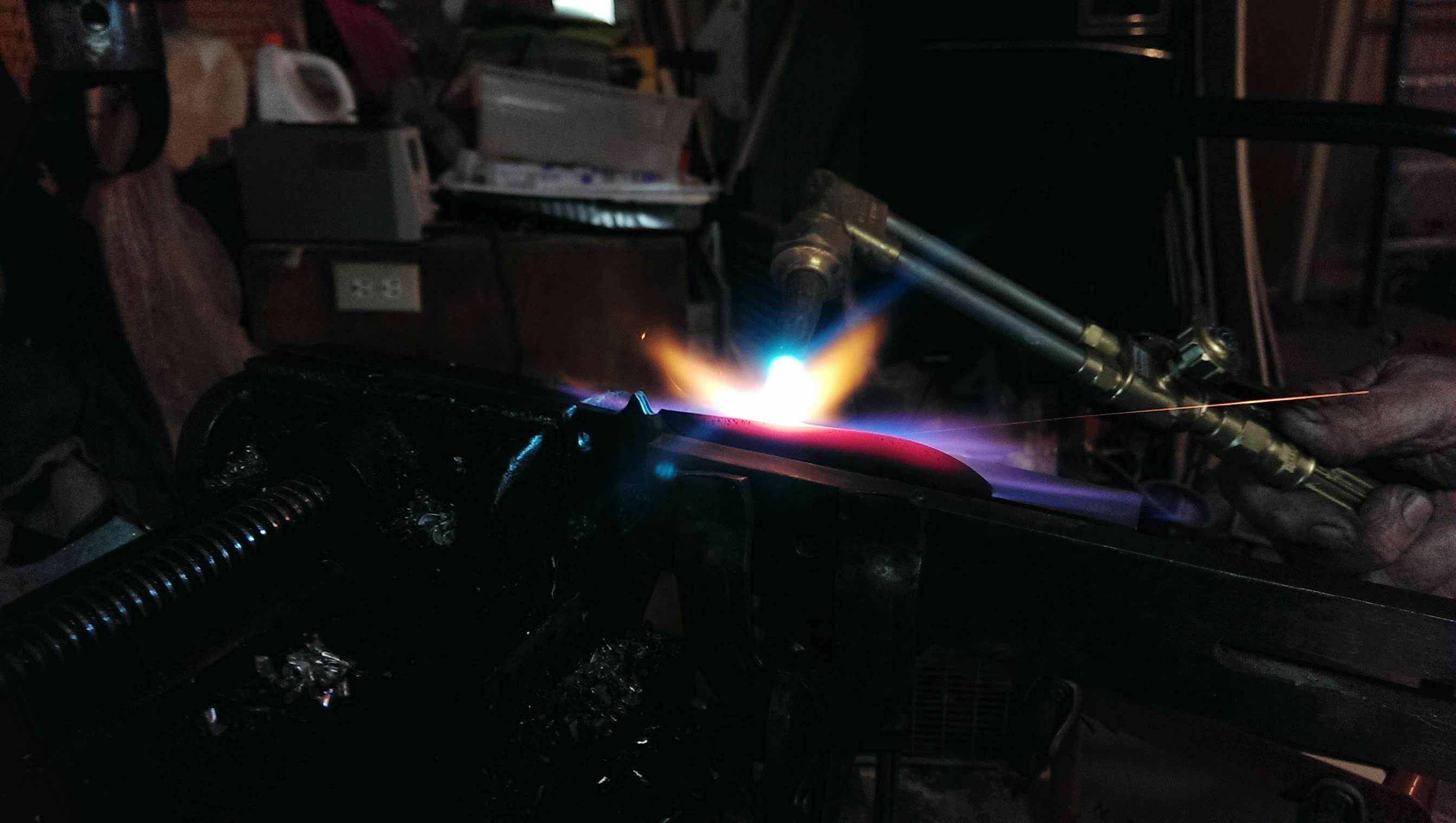

I anticipate there were different harnesses because I was going for a differential heat treat. Here is how we did it.

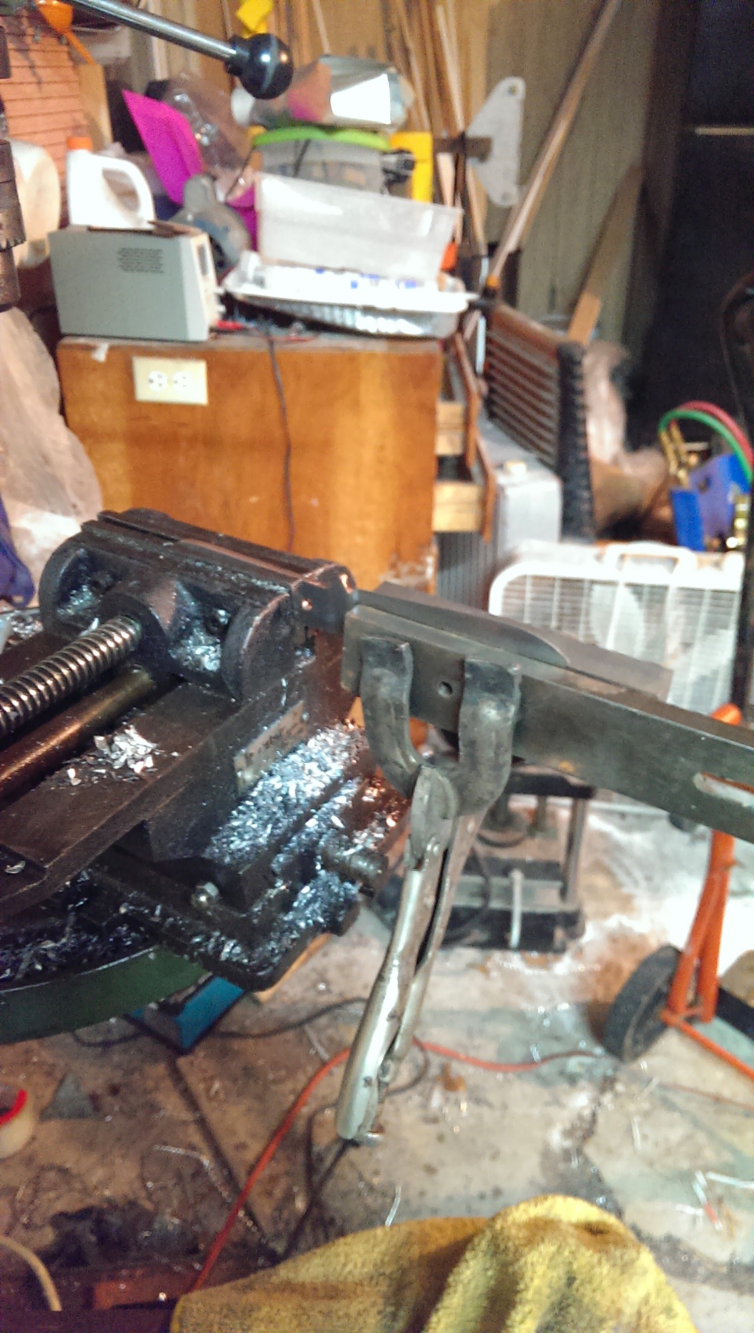

We clamped 2 steel plates on either side of the blade over the spine to sink heat away in those areas hoping to just get the edge hardened.
We used a torch to heat the edge evenly to non-magnetic and then quenched in canola oil.

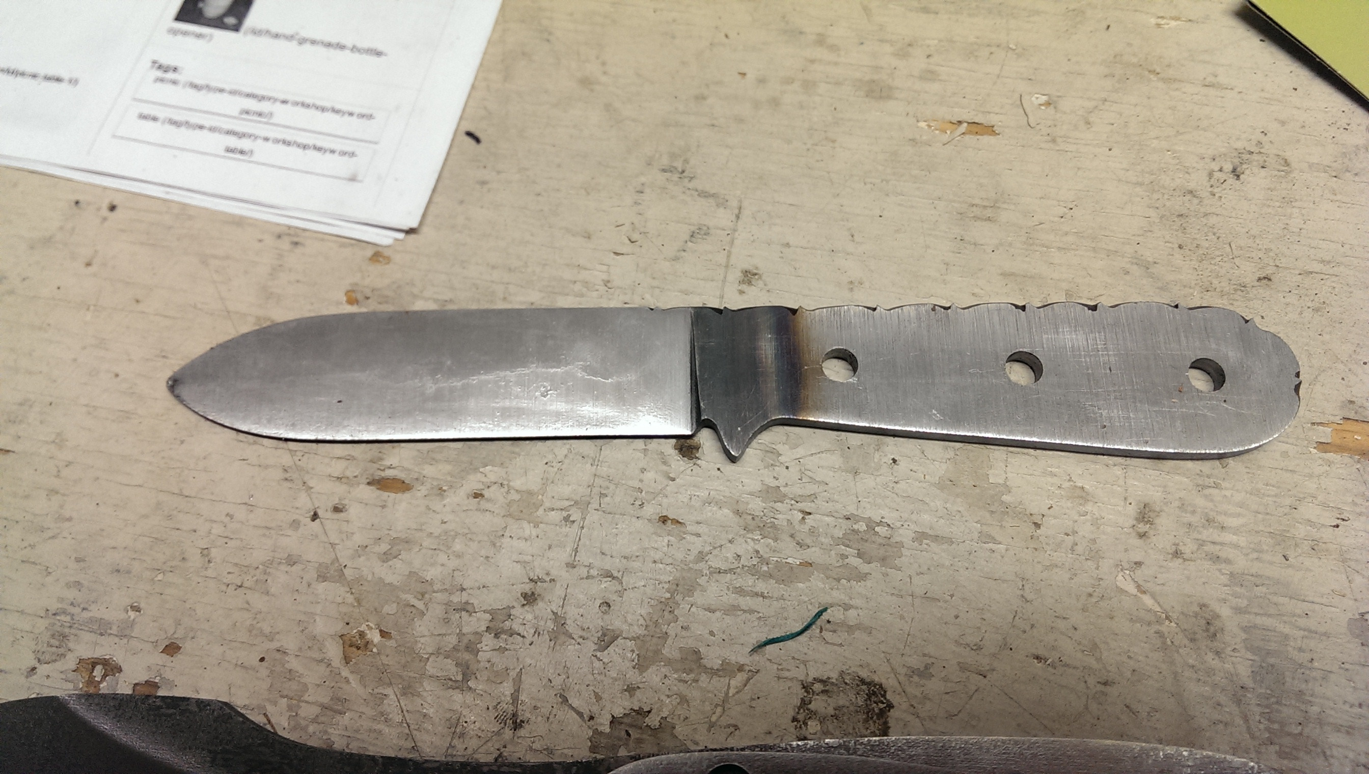

Here is after HT and a little bit of sanding.
After getting the crazy hardness readings, I decided to do 2 2 hr tempers at 400.

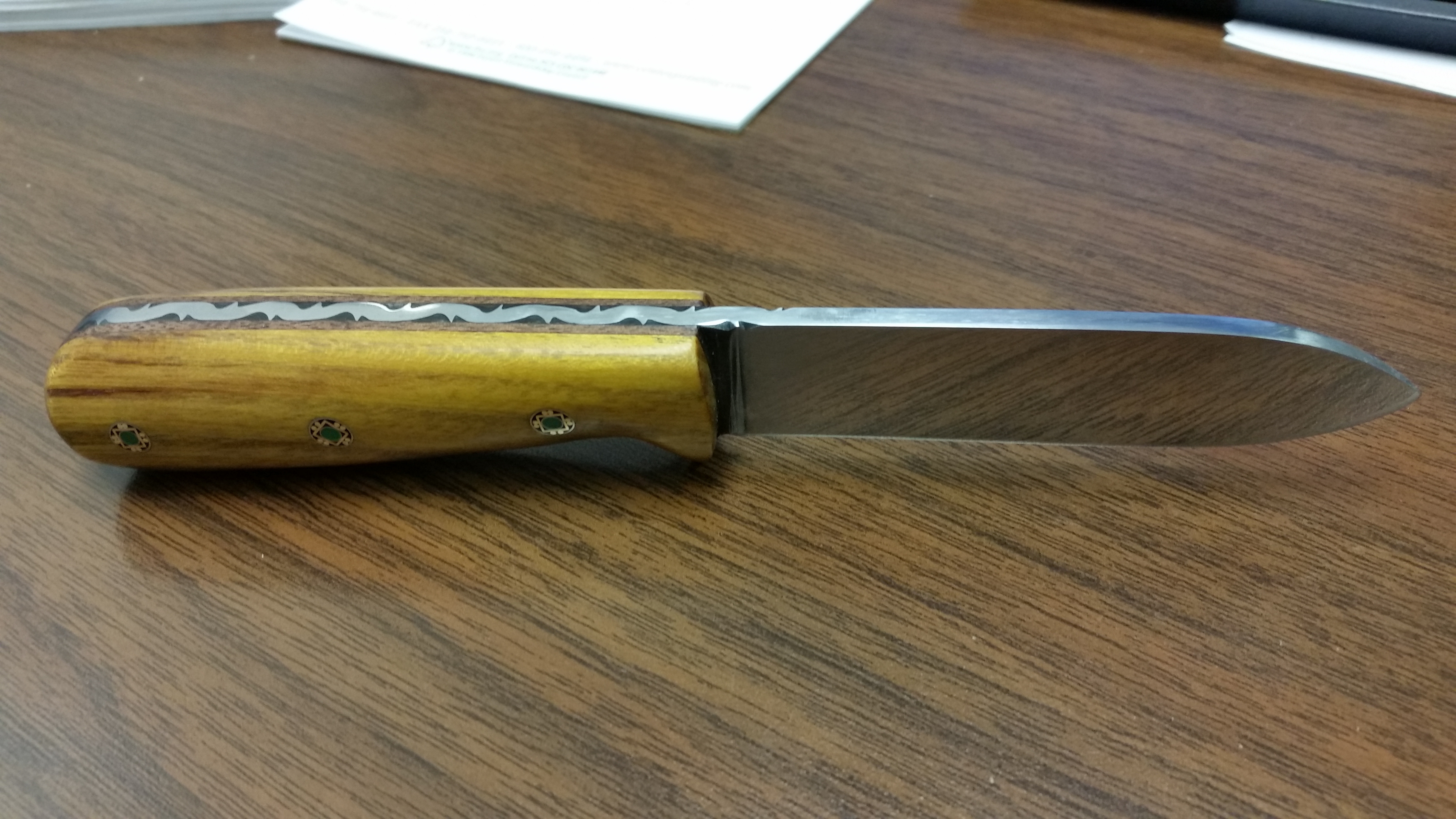

Well, after mostly finishing it and putting an edge on it last night, I fear it has a crappy edge. It was very difficult to sharpen to shaving sharp and i ended up only being able to achieve this on a leather strop with a some compound. I can normally get a blade shaving sharp on my sharpmaker and then use the strop to further polish and hone the edge.
Then I tested it and whittled just a bit on a block of Boisd'arc I have. I know bois'd arc is really hard but it lost its shaving ability and visibly affected the edge after about 10 strokes. I'm thinking there's a problem. Can someone explain where I messed up? I know my temper was maybe a little excessive but that was because our readings seemed to say the blade was so hard. Is there any way I can fix the blade at this point???
I can promise you that your blade isn't 90, if you're reading Rockwell. 1095 maxes out at like 66 or 67 (IIRC). And I think your problem lies in the heat treat procedure. Canola oil for 1095 is not fast enough. Maybe just the edge....but just the edge...got hard. Remember 1095 has like a second to go from temp to 900 or under. Canola just is iffy with 1095. On a Kephart....I would quench the whole blade...not an edge quench on something that small. Also, on your test, make sure that you've cleaned off all scale and decarb before testing...it needs to be on a flat surface, too, like the ricasso, or you'll get crazy readings.
As far as fixing it....no problem. Just redo the heat treat. Don't edge quench this small blade. If you're set on it...then go for it. Take it to 1475 (using a torch this is difficult...but get it a shade or two past nonmagnetic) and hold it at 1475 for 10 minutes (how are you going to do that with a torch? 1095 needs a soak at temp). If you must use canola oil, warm the oil to 130F, and then quench the blade. Water might be better than canola for 1095...but the "tink" fairy could pay you a visit.

I mostly agree with Stu. Ditch the clamp thingy(those plates will never allow you to heat treat properly).

Another concern regards the hardness reading... did You try to get readings on the bevels? Stuart is right, You cannot read hardness but on flat and parallel surface free of any dirt, dust, whatever.
Canola should work for edge thickness sections...get the oil to 100-120°F to speed the quenching ability. After the ht&temper be sure to remove scale and decarburation layer and keep the blade cool while doing it otherwise You may loose hardness very quickly. Good luck, remeber You can test the blade and redo ht before doing handle works ;)

If you are brave, follow Rick's heat treat, quench for 2-3 seconds in brine, then immediately finish the quench in warmed canola oil. 1095 needs to get to Ms temp in about 1/2 second, and even warmed canola is hit or miss. The break happens later in the martensite transformation, as the stress rises. The canola is slower than brine, and is easier on the steel for the later parts of the transformation. I did about 10 blades this way before getting commercial oil, and only broke one blade, but that one was 7 seconds in brine.

I think you overheated the edge with your torch and didn't get past the nose on your quench. Those plates are huge heat sinks. Better to try differential hardening with clay in your kiln. Either bust off the scales and start over or hang it on your wall as a reminder. Everyone has a wall of shame learning.:)
