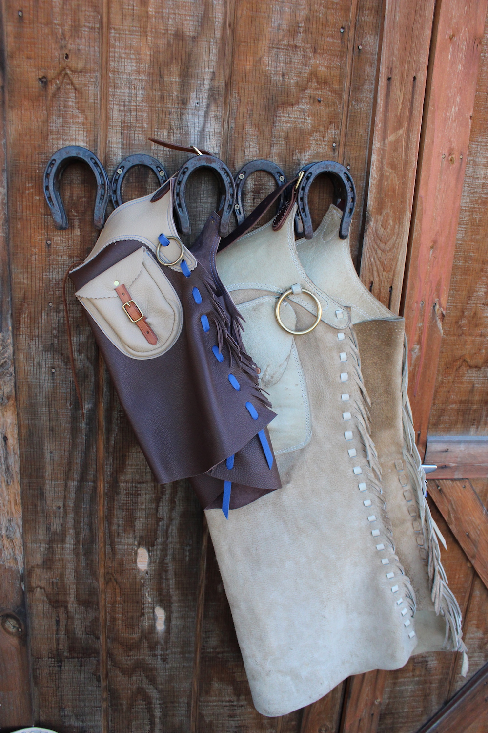

BTW; what is the steel ring on the side of those great looking chaps for? I'm more of a carpenter/construction worker type, not a cowboy.

woodwrkr the ring is to hold a tie rope. A tie rope is a short piece of rope usually about 10 ft long. When leggings (chaps) have them like this pair the tie rope is centered over the connecting string in front and then both tails of the rope is fed through the ring. I cary one on the back of my saddle, some guys will carry like this on their leggings.

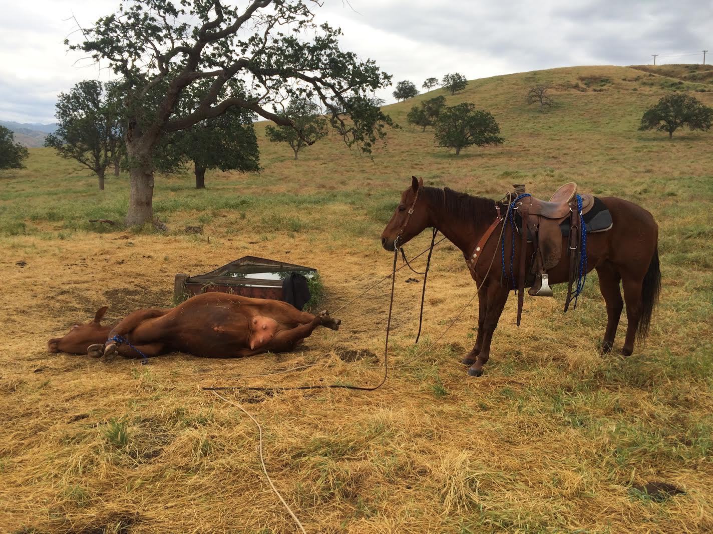

This pic was from my son riding heifers for a large local ranch last spring. So what that means is these are first calf heifers that are about to calve. This particular batch of heifers (about 200 of them) were having aa lot of problems. About every 3rd one needed assistance. So every 2 hours for about 2 months he would ride through this pasture checking the heifers. if one was having trouble he would rope it, throw a trip, lay it down, tie the front feet, have a GOOD horse hold the back and then you are probably shoulder deep seeing what the problem is. If its gonna be an extended period of time you'd probably tie the back feet too, usually to the front feet. All the blue ropes hanging on the saddle are extra tie ropes. This is big boy cowboy stuff so a guy needs to be handy and mounted cause you are doing this by yourself for the most part. Ya can see the Buddy (the horse) knows his job well and is using his weight to keep the heifers hind feet off the ground.

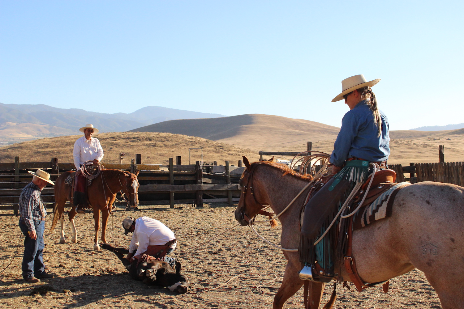

There's lots of different ways of doing things and some of it is regional. If ya got two ropers ya can just lay em down like my wife and I did here. Head em, heel em and the ground crew will take the head rope off stick em on the front feet and go to work. Salty is rapidly making this bull calf into a steer, with Shotgun Stewie standing by with the branding iron. No "tie" ropes used this way just "catch" ropes.

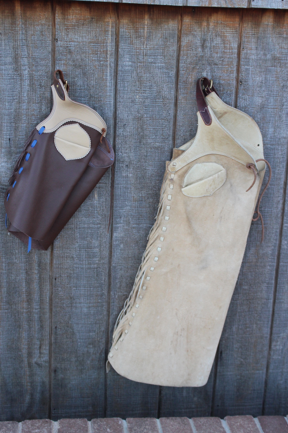

So on the chap trade the whole project was to make something similar to dad's.
Kinda took me out of my comfort zone because I've made hundred and hundreds of different pairs of leggings but never this style. This chap style is called AZ bells. I've made: chinks, charmitas, armitas, shotgun chaps, batwing chaps and even bear hide woolies but never a pair of AZ bells. Never made this type of pocket before here on the right leg. Its called a mitten pocket.

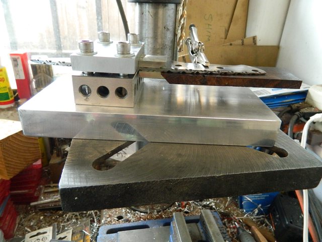

Josh here is another way it could be done as well I assume. The same logic could be used in this situation. This is how I plan on doing it. I want to make one of these for doing distals as well.
http://www.bladeforums.com/forums/showthread.php/1412807-Fitting-Scales-on-a-(Distal)Tapered-Tang
Here's one way to do it: Taper you tang all the way up under your bolsters if you want bolsters. Make sure you drill your holes for pins before you taper the tang. After fitting your bolsters you may use a little super glue to tack one side of your scales to your blade and then clamp into a jig like this. I copied this one from David Sharp. Drill your holes and break the scale off the blade and then glue the other scale to the blade turn over and repeat. That's it. The other method is for guys who want their taper to stop at the bolsters or guard. Then you must fit the scales to the bolsters by trial and error because they will not be 90 degree perpendicular anymore an will be about 1/2 a degree to 1 degree off. You have to sand the face of your scales at less than 90 degrees and test fit to the bolsters. When they fit you can glue the scales one at a time to your blade and use this jig to drill the holes. Larry
