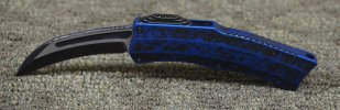

Hi guys,
I have a hawksbill that I'd like to get a killer edge put on it. Who is the moderator on Bladeforums that is a knife maker and also does a sharpening biz? I'd like to reach out to him.

I'm just getting lazy. I have an Edge Pro and Sharpmaker. I don't think the Edge Pro would work. I'd like to get someone to set the angle to 20 degrees so I can maintain on the Sharpmaker. Any ideas who would be able to do that? I looked up Josh and he's also not currently taking sharpening jobs.

I would think a guided sharpener would work as long as the stones used had the corners rounded and not squared off.

If you have the stones from EP that are not as wide that would help. I have not done that blade shape yet so I cannot give any more specific advice for the EP.
Machinist and die makers use curved and round stones in all the usual knife grits.
Look at Grainger or Congress Tools for the size and grits you want. India, Silicon Carbide, Arkansas and diamonds are readily available.
Ebay regularly has batches of used machinist’s stones. So that may be the lowest cost place to look first.
Big Dave Big Dave I think you'll want to shoot for under 20 degrees per side if you want to maintain it on the Spyderco. That way your 20 dps microbevel is less work to maintain since you won't have to remove as much material on your sharpening sessions to bring the apex back.
