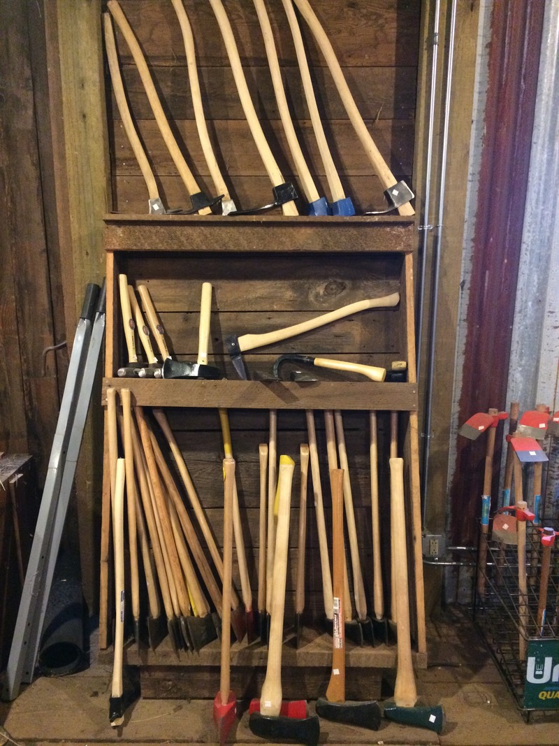

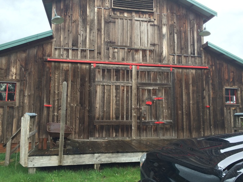

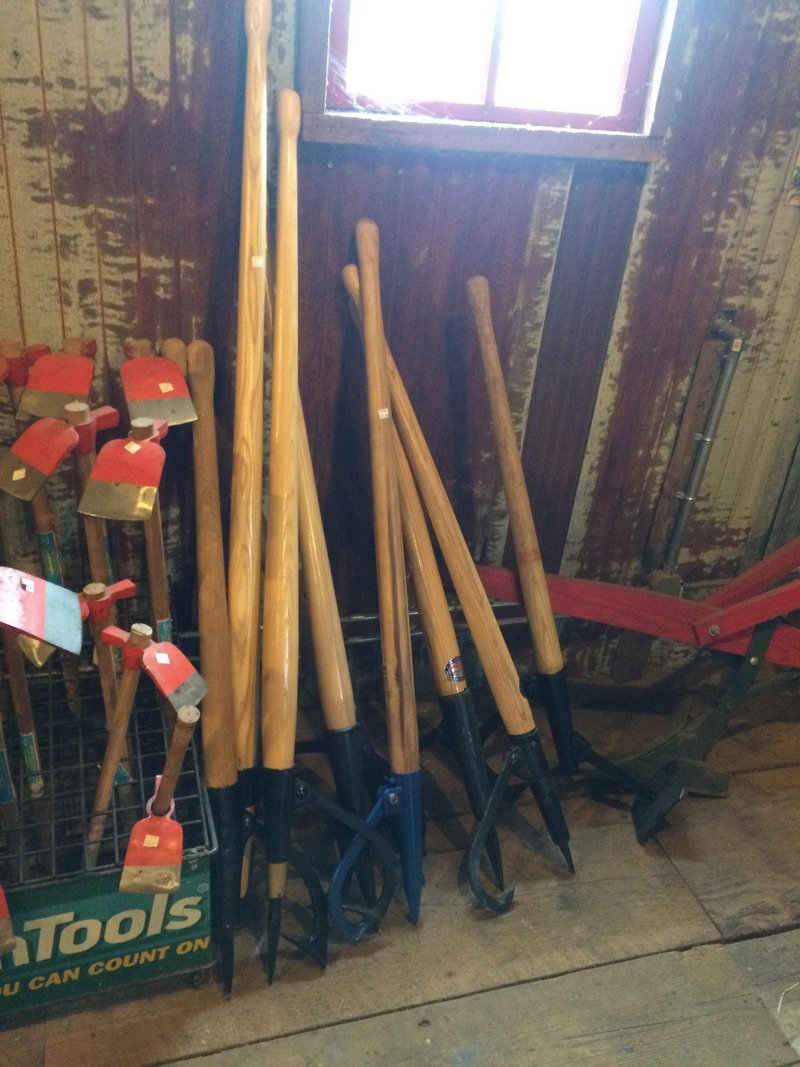

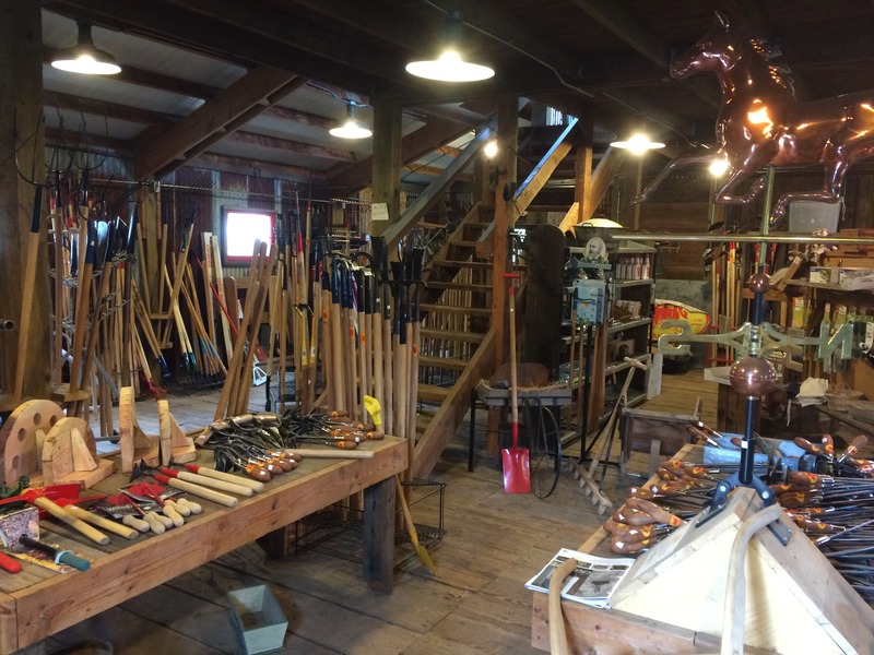

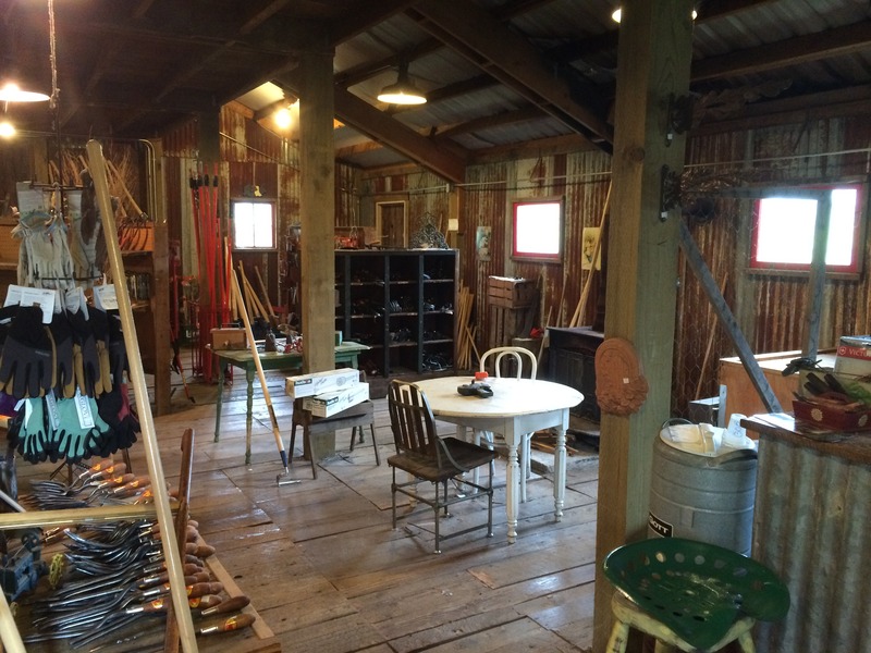

Oh by the way, this is a neat place. Here are some pics I snapped off this afternoon. The forge is in a separate building and the owner wasn’t around to pester, in fact there wasn’t anyone manning the shop – ring the bell LOUD for assistance. I drive by this place every day and didn’t know until recently that it existed.
This isn’t an advertisement and I am not “friends” with them, just seemed to fit in with what goes on around here. Not bad for a place named, "Boring".
The barn/shop:
Good stuff inside:

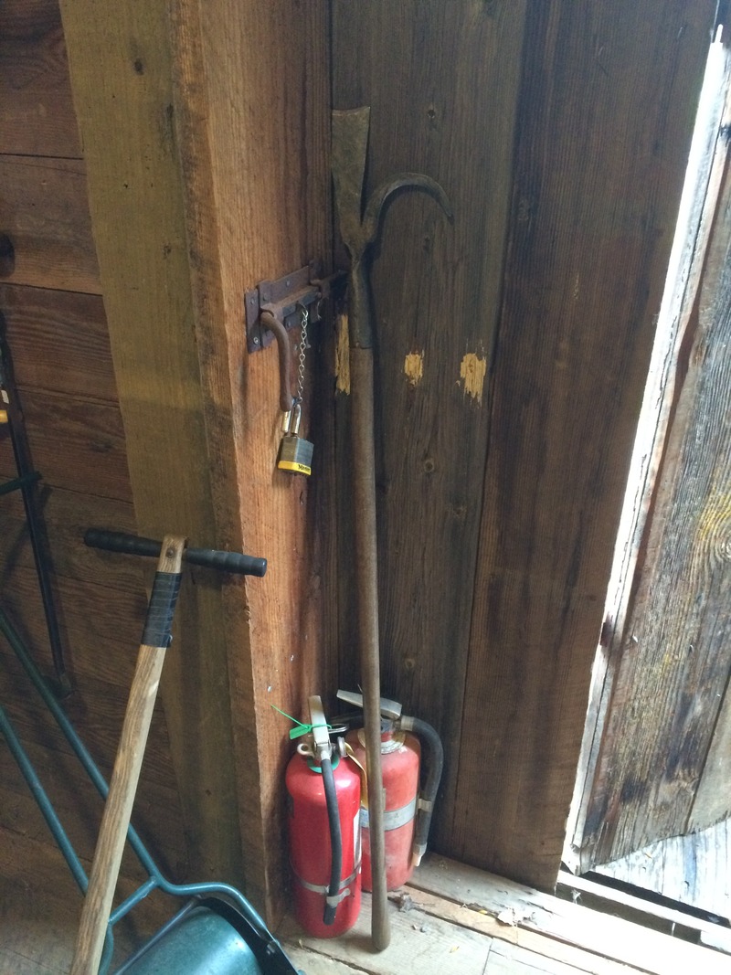

Need to move a log?

Upstairs is a “museum” of sorts. Old farming equipment – some of it I have never seen. I bought some forged garden tools for my mother here – she seems to think they are too cool to use…
