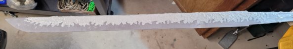

The bone is fit and it is ready for the hamon.

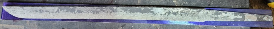

The first blade did not survive heat treat. It took a crazy warp and cracked when I tried to straighten it in the temper. I am pretty sure the warp was from me pulling it out of the oil to quickly. I had a couple 2x4s set up to clamp it straight and didn't rest it long enough in the oil. This type of blade with the clay bends down first and then back up in the oil. I think I pulled it and clamped after the bend down. I should have just cleaned and redone heat treatment. You can see the crack in the middle

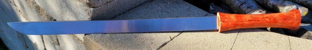

Good news is the second blade worked out perfect. I decided to redeem myself with a CPM3V blade. Everything went according to plan with this one. It is at 120 grit here.
I started shaping the bone. It is going to get thick copper collars at both end and probably some copper strips. I haven't decided if I am going to do an ito wrap with some carving showing through the diamonds on the bone or a carved leather wrap.

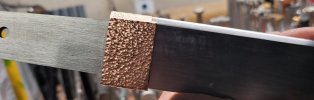

The Habaki turned out nice. I textured it with my carbide hammer. I am going to do a forced patina maybe with some ammonia to get some green and then buff it for a two tone look.

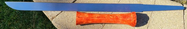

Here is an omerta update. Unfortunatley the bone didnt work out. Even epoxy filled and stablized it didnt seem sturdy enough for a sword. Most of the other bones I have used had a really thick wall. This one was maybe 1/3 as thick as the others. I scrapped it and went with rosewood.

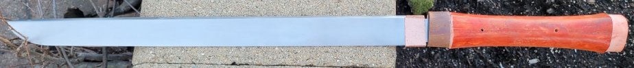

The current wrap is leather which I think will be getting replaced with silk.
I made and installed copper menuki on both sides.20240627_142329.jpg20240627_142336.jpg20240627_142342.jpg
