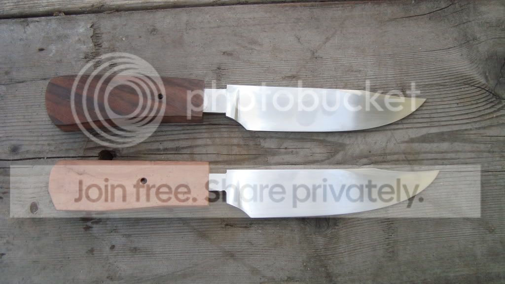

So I have a couple of projects on the go right now and thought I would share them.
Knife wise I have 2 bowie like knives on the go, both are just shy of HT ready, I need to do a bit more sanding on them first. the one with the thicker tang is getting a brass single sided guard, red spacers on either side of a brass spacer with a Claro Walnut handle. The other will have a redwood burl handle same style of guard but the spacers will be black instead.
Steel: 13/64 5160
blade length: 6 1/4"
handle length w/guard: 5 1/4"
OAL: just shy of 11"
Both are full flat grind, all done with files and sanding
Next on the knife board is a pair of bushcraft knives and my first attempt at scandi grinds both are roughly the same but I added a triangular lanyard out past the handle material on the second one. I will be cleaning out the hole with files and rounding out the corners and putting a radius on the inside edges before HT. I will be using maple burl for the handles and will be giving them the ever popular coke bottle profile for a more secure grip. they will be held in place with 3/16 brass pins and have black liners. I have the bevel on the first one and just started sanding today. This is the first time I have tried to cut the bevel in with my crappy little 30X1 grinder. I had to go back to the file and jig to square things up but it wasn't too bad and went much faster then going with the files all the way. I am happy with the way the grind is coming on the first one, the grinds are even as are the short plunges.
Steel: 3/16 O1
Blade Length: 4 1/8"
Handle Length: 5" and 5 1/4" for the one with the lanyard
OAL: 9 1/4" and 9 1/2" for the one with lanyard.

I should have pics up some time after 7:30 for anyone who wants to see.
