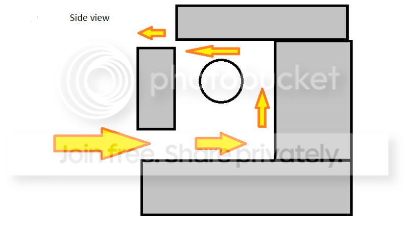

I have some drawings on a forge where the muffler is indirectly heated mad by Tubal Cain. He says that he has maximized the furnace fore one burner and the muffler tube is only 6" so i guess 4" blades is about what you can heat. This is a rough sketch.

If that forge is only 6" long, it is too small to do much.
I would suggest a forge with a 12" to 16" length. A 12" forge can run on one burner, and a 16" forge does well on two.
I am sorry the pic i posted was of another forge. The one in the first post seems to be less suited fore HT than i hoped (fore the reasons bladsmth
stated).
