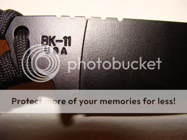

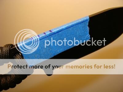

I had did my bk11 when I first got it and did a detailed post of how. Here are the pics..ya just need blue painters tape, ruler, dremel tool with cutoff wheel and a file. No drilling as Daizee said.
a simple round chainsaw file will make those half-rounds. just file down half the thickness of the file. Lots of sizes available at your average hardware store for just a few bucks. (get or make a handle too)
when you lay out your guide lines, remember to account for the file width.

If "handy" with a dremel..use the thin cutoff wheel to "mark" jimping on top of the blue painters tape..then follow up with a file.
One of the most even ones I've seen.
