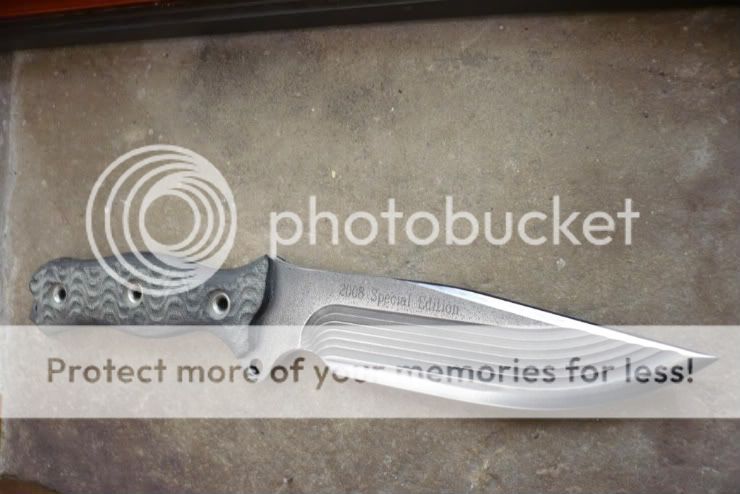

Here is a picture of my CE Jackhammer
I have re-profiled the convex edge to a sharper less obtuse angle and sharpened the swedge so it can perform as an obtuse edge for ferro rod strikes and bone work on dressing game such as an Atlas joint split.
As a fighter the knife can now cut on both sides but I doubt I would need that feature. It does make the knife easy to remove though...you can cut both ways to pull it out and the grooves would help prevent any vacuum "suck" on such a wound.
The knife has a dull finish apart from the edges and I like that. Rust should not be an issue if properly looked after. If de-carb is a big concern get an oven cleaner Brillo Pad and give the knife a good scrubbing...this will remove most or all of it and the "pink" chemicals in those oven cleaners make short work of food prep stains...tanin stains from bark or sap...or get dried blood out of the grooves. They are cheap and work with elbow grease like a Scotchbrite Wheel on a grinder.
If you are really concerned about the rust...you could get the knife Double Cut in a beadblaster. I would go for a glass bead finish as opposed to using sand. It will dull the edges though and these will have to be restored. I just did a NMFBM like this after stripping a combat finish. These combat finishes now seem to have a beadblasted substance under the paint. Not sure what it is but it is a devil to remove before beadblasting. So for me a CE finish is cheaper...less work to prep the knife if you want to do your own finish...and even on it's own is a good alternative to D/C so long as you have sorted the De-Carb out or look after it properly so it is not an issue.
