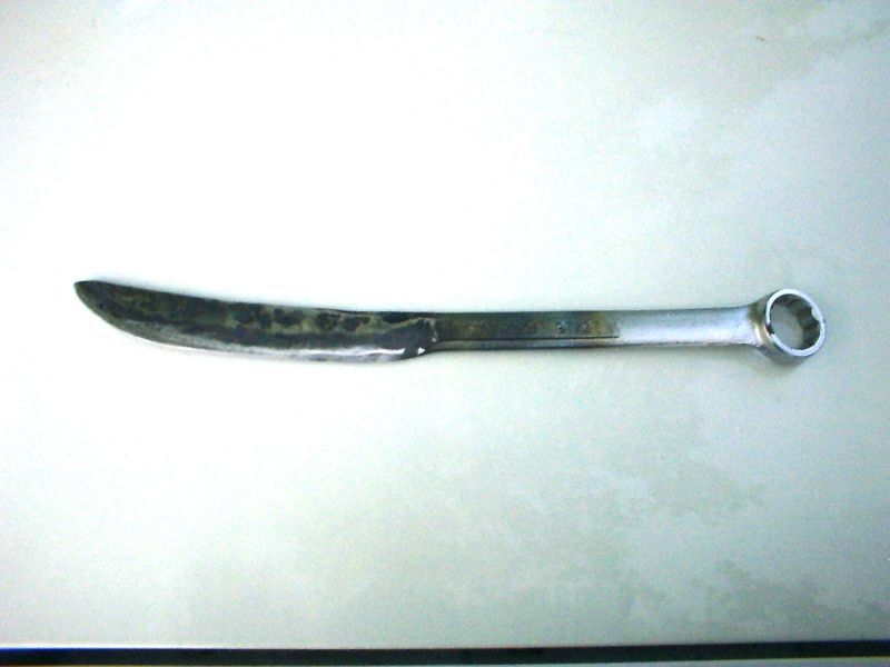

Hi all,
Another question will be: Could a screwdriver or wrench be forged into a blade?
Thank you for your time and sharing!
This is one I made for my brother; he has been a mechanic all his life.

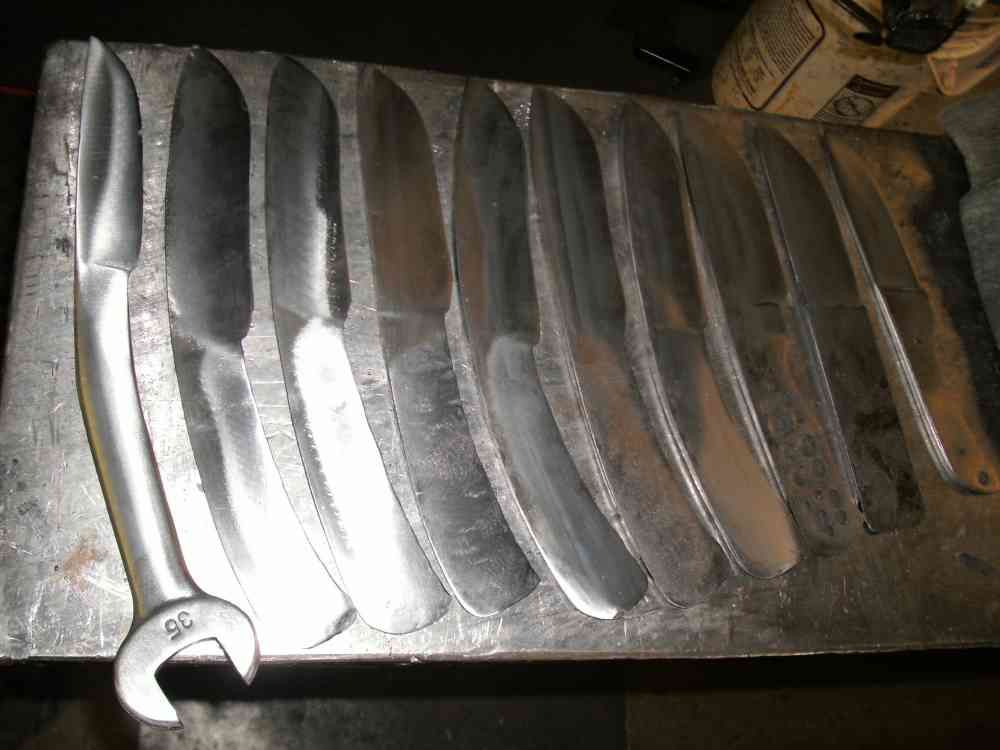

There really isn't any mystery steel .You just have to take the steel to a laboratory and have it analysed !! HT may be a little bit more complex.
What would be the cost of this? Why would you want to do this when there are known steels that are readily available that will provide excellent results following published parameters. I ask this respectfully, just curious. Maybe if you got a batch of steel for free.
going by the specs that material sounds an awful lot like S7.
That is the problem...we don't have any specs. Just sales hype about being the most this and the hardest that.
When I buy a bar of 1084, I know what it is. When I use 52100, I know what it is. When I use a John Deere drive shaft, I know what it is, .....because I have the specs from the suppliers. Using a wrench of unknown specs for knife steel is pretty foolish, IMHO.
Maybe a new approach to steel selection is needed....lets try this:
If you found a can of some liquid in the garage, would you pour it in your gas tank just because it burns when ignited?.....NO???
Then why would you make a knife out of some metal you found in the garage just because it was hard?
Steel analysis is mostly done on automatic machines , very quick !! Companies like Fastenol will do it for you IIRC and cost maybe $ 50.
If you order large amounts the steel company will make it to your specs. Getting the ideal HT will take time and some money but nothing unreasonable.
