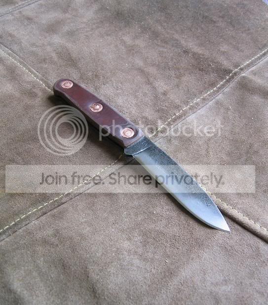

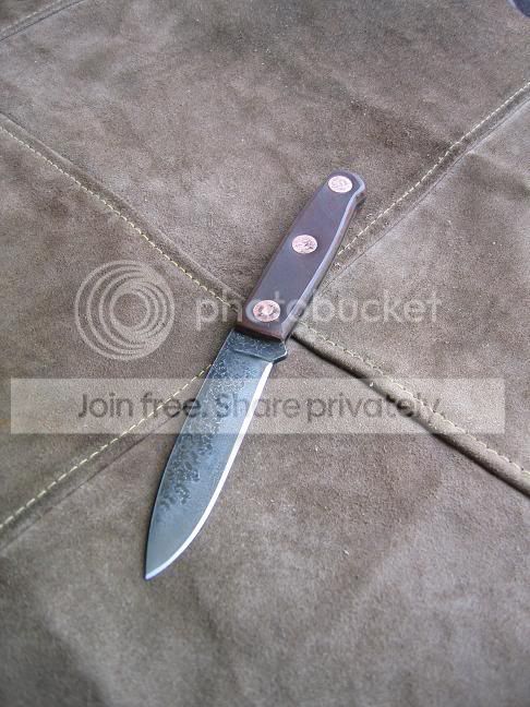

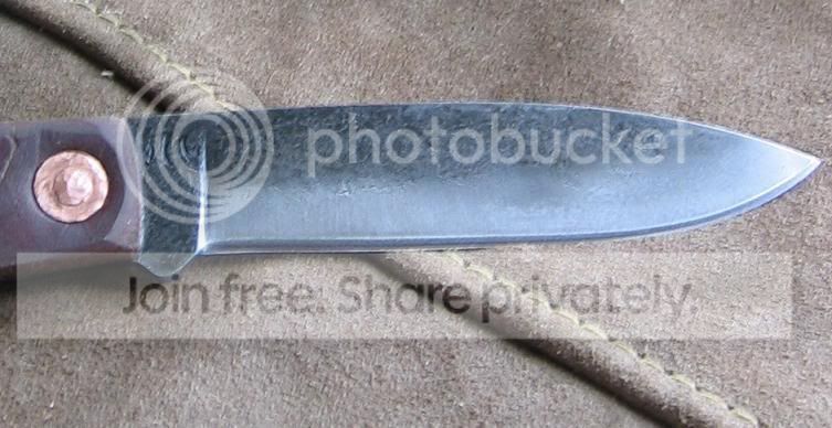

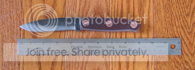

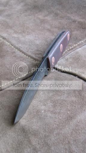

I haven't seen too many knives with leather scales.... so I got this brilliant idea that instead of looking around to find out why, I would just make one as a prototype and see for myself. I was gonna hang on to this one.... not knowing whether the scales would hold out... But instead, found a sucker... er, I mean tester to take it off my hands for cheap, put it through its paces and report back.
W2 steel
1/8" thick
Leather handle scales... epoxied, riveted and hot dipped in beezwax mixture.
Sheath is a friction fit fold-over pouch dangler. (not shown)
No lanyard hole.
Rick

I like those pins too. My only suggestion would be to make the blade a touch wider. I love the finish on the blade also.

That ROCKS!!!! I have done a few mountain man style throwers and belt knives with leather slab handles. A little epoxy and beeswax makes for a very durable handle :) Eventually with use the handles mold to your mit too in a subtle way. The harness rivits add to the charm and surely they aren't gonna let go anytime soon.
Did you use butt leather for that? Or maybe 12 iron soles? Where are you getting the W2 flat stock?
I forged it from an old file that was almost 1/4" thick.... it may be 1095... it was a nicholson file.
I think the leather is 13oz or something.
