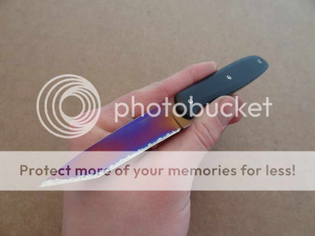

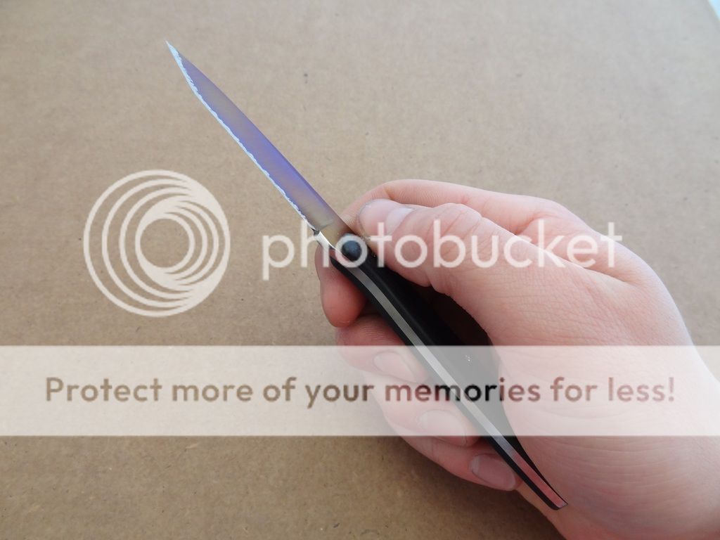

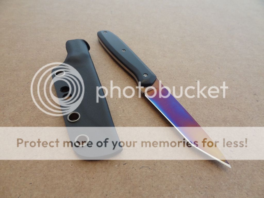

Hey guys, this is one of my most recent builds. It's a prototype for a new model called the ES-65. It's made out of 6AL4V titanium that has been heat anodized and tungsten carbide coated along the edge. It's 6.75" overall with a 3" blade. It's hollow ground to a little under 0.010". Black G10 handles with screw construction. Comes with a Tek Lok compatible Kydex sheath that can be carried vertically, horizontally, or at a 45 degree angle. Price is $200, insured US shipping included. Payments: PayPal (email Mitch@VanguardForge.com) or head to VanguardForge.com/available. Thanks for looking everyone! Hope you have a great day :)

Not a stupid question at all. It's a chisel ground edge, so you sharpen the reverse side. Have to be careful about creating a burr because they're a nightmare to get off. Low grit stones are needed too; the coating has really large carbide grain sizes, so if you move past a certain point in grits you'll just cause tearout. I personally dislike the coating. It's a pain to sharpen, but everyone seems to prefer them and they have a unique way of "self sharpening." Granted, we're talking about a very toothy utility edge, so don't expect to shave.
