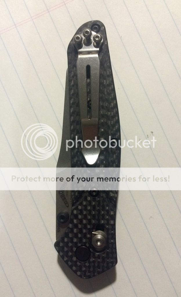

Is it normal for an Omega spring to be sticking out of the liner like this? Knife is a 940-1

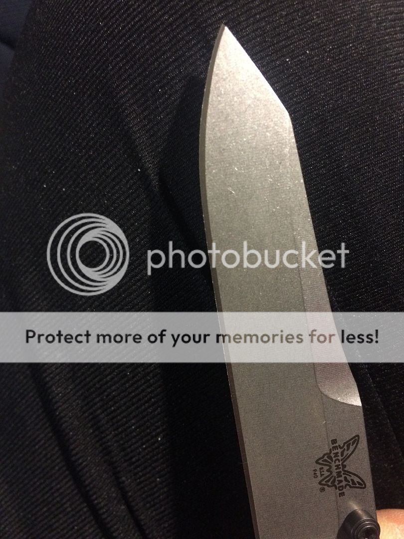

Thanks. Do your 940s have unevenly finished shoulders before the blade tip? This gives an impression of poor centering.
Also, will Benchmade shear the excess screw threads that protrude out the liners?
it is common for the grinds to be a little off on the end of the blade just before it slopes down for the tip. That has to be a tricky grind to execute on that knife. I believe they may be able to send you shorter screws if you call or email and ask for a set. I don't mind the longer ones though.
But the omega springs are supposed to stick out. That is what keeps the tension. if they weren't stuck into the liners they would have no tension and thus not work at all.

I started a thread awhile back on the official Benchmade forum about the protruding screws, to try and determine if this was a defect or intentional. I can't answer the quoted question, and I'm a total layman when it comes to knife manufacturing, but Jason (design engineer) of Benchmade offered this explanation, which was helpful:
"The 940-1 is designed so that there is ALWAYS maximum engagement from the liner screws into the cartridge liner, because it is a relatively thin liner.
In a production environment, the final dimensions of various components and features (such as handle thickness, counterbore depths, screw lengths, chamfers, etc.) vary accordingly with the capability of the manufacturing processes used to create those features.
So essentially, we bias the design at nominal conditions so that the screws stick a little bit through the liners, so that if screws are short, counterbores are shallow and/or chamfers are oversized, the screw threads will bite throughout the entire thickness of the liner. Not only does this give the knife more strength and stability and more firmly locate the liner in the handle, but it makes it so that you are less likely to accidentally strip a screw, further compromising the integrity of the assembly.
However, this also means that in the opposite condition, the screws may stick a little further through the liners than intended.
Long story short, sometimes the screws stick through a bit and sometimes they're essentially flush to the liners, but they will always have max engagement with the threads. However, they will never interfere with the blade. There is plenty of clearance.
Functionality is always the focus, because at the end of the day, these knives are tools and must be able to be treated as such.
Hope that provides some clarity.
Jason"

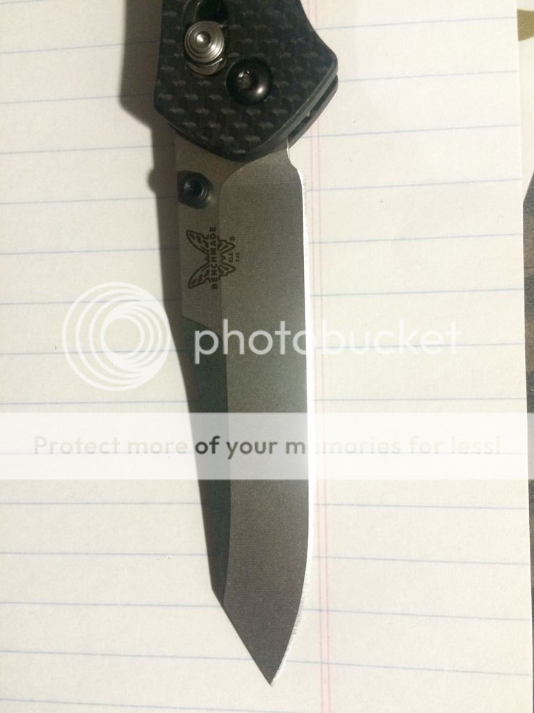

Ok so I got my 940-1 back from Benchmade, as promised here are the run down and pictures:
First let me list out the to do list that I noted to Benchmade on the warranty form:
1. Replace blade due to uneven grind from one side to the other and recurve in the middle of blade that should've been flat.
2. Make sure the blade is centered and swedges match
3. Have black thumb studs and stone washed split arrow clip or black if not available.
4. To address the protruding screws inside the scales.
And here are the pics, you guys see it for yourself
Packing was well done and I included the paperwork showing the work order they listed at the bottom of the page
New blade is Straight!! No recurve in the middle
Scale screws are still protruding... I still don't buy the whole story that the screws were intentionally designed that way, the regular 940 doesn't have this issue and many other models don't have this issue yet this premium model of the iconic 940 has... My opinion is they just don't want to spend the money and order a slightly shorter screws for 1 model knife that won't be shared by other models, understandable in a manufacturing stand point but again this is a upgraded premium model.
And here they slapped on a regular chrome split arrow because they don't have stone washed one. Way to ruin the esthetic..... They did put on the black thumb studs for me thou
Remember I wanted matching swedges on both sides? And... This puts evenness into a whole new meaning.... Again this is THE premium model which they claimed to be made with best material and craftsmanship.
This BRAND NEW blade doesn't cut/slice very well.
Why? They sent it off with a pretty evenly distributed burr still on the blade, it's not even a wire edge, I was unable to strop it out and it needs a sharpening to correct that problem which will cost $30-40 to have Josh (razor edge) do it right. Again, Premium model from a top knife manufacture.... I don't mean to bash but if any of you think this is acceptable should go see a shrink.
I am totally NOT impressed; I can understand these type of flaws coming off production line and was a quality control oversight. But coming from warranty department where their only job is to make things right and this is the end result?

That sloping transition on the spine seems to be present on all the 94X. I can't believe that's a hard problem for them to fix. It's just sloppy.
