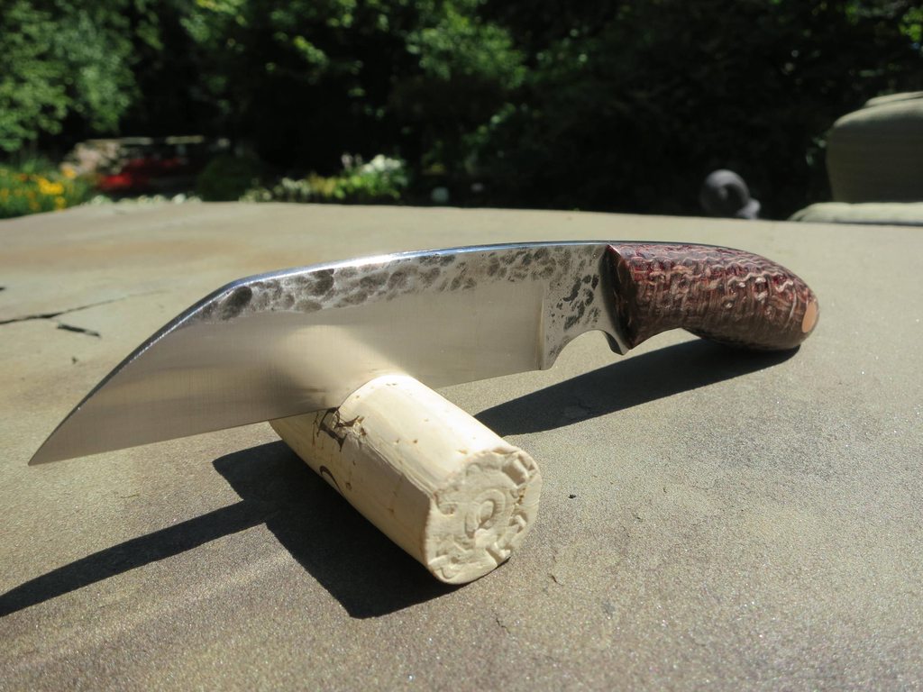

I did something similar for one knife. I wouldn't really call it a fake "brut de forge," as it looks nothing like a forge finish... rather just a hammered/textured finish. I do forge, but this one was done entirely cold. Was kind of a spur-of-the-moment type thing... I just took a ball-peen and went to town on the cold bar of steel before profiling it out. After heat treatment, I just went over it lightly with high grit sandpaper to shine up the high spots.
I have mixed feelings on the results personally, but it seems to be popular among people I've shown my knives to... especially non-knife folk.

Weebus, are you kidding? I like everything about that knife. The wharncliffe is my favorite blade shape, and while I'd consider that a modified version, it looks like it would have all of the utility with a bit of style.
Is that burlap from Shadetree? Looks very familiar. :)

Haha, I'm glad. Seems to be a fairly polarizing knife. People generally seem to either love it or hate it... I think it ended up a bit tacky, but I like certain parts about it. The guy who has it now loves it, so I guess that's all that matters. One thing to keep in mind is the finish on the hammer face, as it'll imprint it directly into the steel. I just used a rather worn ball-peen, but if I were to do it again, I would probably make a specific texturing hammer to get what I was after.
The handle material is indeed from Shadetree, I believe he calls it "drunken coffee bag." Interesting stuff (also seemed to be very polarizing, haha). Wharnies and sheepsfoots (or slightly modified versions) are my favorite as well, so they're about all I make when I do small knives. I love little utility knives.
