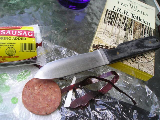

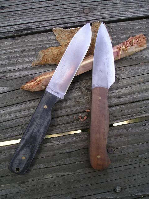

I got the PSK Sr. in the mail today! I had some time this afternoon so I wanted to put together a little mini review.
First off, the overall work is of high quality. Meaning, it's obvious Scott was paying attention to details. The handle fit is precise, the angles on the steel are all spot on, etc. I like the micarta slabs, they are pretty comfy.
As someone else mentioned, the steel could use a touch up. So many sharpenings have not been all that kind to the grind. It still came with a sharp little edge that would shave! Some re-thinning of that grind would make it really slice, though.
I tried it on a few basics, for now: food prep, fuzz sticks, drilling and batoning. I wasn't able to snap pics of it all before the camera died!
Comparison shot with the Farmer:
Some *very* teensy curls that didn't show up that well:
A snack- it had a hard time biting into the wrapping:
In-hand shot:
I tried using it on a new firesteel, but couldn't snap a pic in time to get the sparks or the flame! There were two small problems with it, one being that the new firesteel is sub par, and that the spine wasn't quite square enough to bite.
Overall it's a good design. Once it hits Mr. Gossman's sander I know it will be right back in shape to be a primary woods blade. The handle design is solid, but less curvy than I'd like. But that's because it's a larger reincarnation of a smaller kit knife. Some thicker slabs would have helped a lot for my big paws, but again that would start to detract from it's 'PSK-ness'.
I really liked the O1, the blade length and thickness, and the handle length. All big pluses. I didn't get a chance to snap a pic of the batoning, but it did quite well through that. I expected it to excel at hard use tasks after reading other reviews of Scott's work, and this wasn't a disappointment.

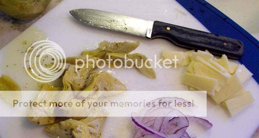

When I got the PSK Sr. the edge would not readily cut paracord. Using my minimal sharpening skills I got the knife sharp enough without doing damage to the blade to make some fuzz sticks from birch bark and shave some fine tinder, cut some paracord, do some whittling and repare some cheese, onions and artichokes for a salad. This is the picture I have included in the post.
I was planning to take more pictures and spend more time with the PSK Sr. but events conspired to prevent me from doing so.
The finish on the this knife was what I expected since I already have a PSK.
The fit on the handle is excellent though I agree that the handle could be just a slight bit wider.
