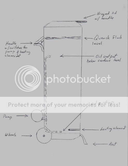

Stacy here is what I have designed for the quench tank. It is a lot like a stand up compressor. This is a crude hand drawn sketch of what I have in mind.
So what do you all think?
Looks good but you might wanna move the p/u a little higher to keep it from getting clogged with scale or bits of clay that fall off the blade when quenching. After you get the bugs worked out and find a steady supply of parts i bet you could sell a few.
Yes I agree Darrin. I plan on bringing it up off the bottom some, and maybe putting a shield over the top, like I said its a rough drawing. I have been thinking about this for a while.

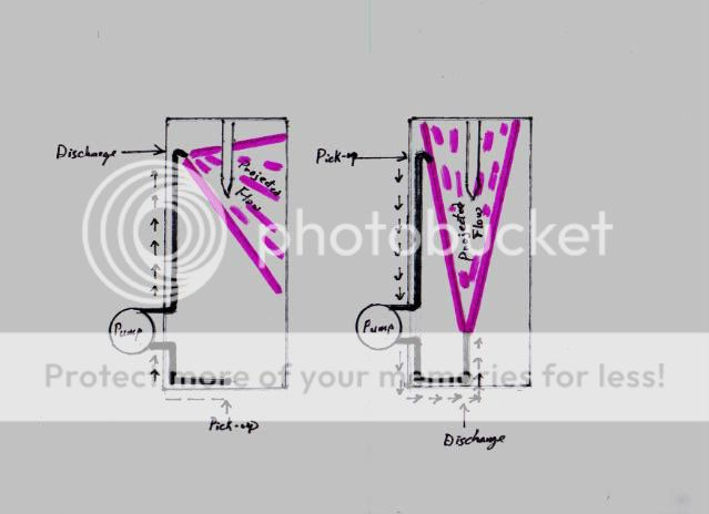

The oil flow needs to be the other direction than drawn. It should exit the pump in the bottom center and jet straight up the center of the tank. The return should be at the side near the top. This causes the oil to run along the quenched blade. It speeds and evens the quench.

Well I am beginning to think I never should have never posted this drawing. The drawing is crude and is basically for my purposes.[/B]My idea is the pickup is at the bottom of the tank and the return is below surface at the top.
OK I went back and looked at my drawing and now I am confused. Stacy you are saying the pickup needs to exactly opposite of what I have drawn. And thinking about the way you worded your explanation. If the pump returns it from the bottom in an upturned pipe I can see where the flow would be directed back to the surface. However I am not convinced at how far up this returning stream would travel! If it does go high enough that idea works well.
My idea was that with it flowing in at the top under the surface (my thoughts was a slightly downward turn the pipe returning the flow) would aid in the agitation as well. I see your point on this Stacy but I would love to hear a little more! I am thinking by your explanation you feel that your direction would make more mid point agitation and the way I have it would make more surface agitation. I could use a little clarification as too which direction works better and why. Now you really have me really questioning which direction is better for the most agitation, but this is good as I want to get this build right the first time!

Count, I see what you are talking about but I wanted the pump low for balance reasons. The pump will have a valve on either side (not shown on the drawing) of it that can be closed for removal of the pump should it be needed and that will allow for minimal loss of quench oil! My main concern now that Stacy raised the issue is direction of flow and why one is better than the other. I want maximum agitation and now I am questioning myself which direction of flow would be better for that. I can visualize both in my head and now I think about it Stacy may be right with it coming out from the bottom and rising in a stream. From the top down would be more close to the surface agitation, and not sure the flow would encompass the entire blade on a longer blade.

I just looked at the drawing again. Your heat element is on the bottom. So why the pump? I ask because it seems to me, if you were to mount just about any old metal fan blade on the end of a shaft driven from above the tank could be used to de-stratify the quenchant, the fluid convection will manage the rest of the work. though it does seem to require a change in the design of the vessel to ensure the pumping action and the quenching action don't interfere with one another.
Also a fan blade mixer would require less maintanence than a pump, and not be prone to particulate troubles.
Your sketch is fine.

Lets go to your drawing for clarity. The way is should run is:
The oil is drawn FROM the top of the tank.
It goes down through the pump.
It comes OUT the fitting at the tank bottom.
There is a 90 degree bend pointing UP the tank from the center bottom.
The stream from the bottom will cause all the oil in the tank to circulate up the center, and down the sides. This will create the optimal agitation and quenching situation.
If the pump expelled the oil at the top and sucked it in from the bottom, there would never be even circulation.
The center jet can be a piece of copper plumbing tubing with an elbow on the end. Just friction fit it into the pipe coming through wall. The elbow doesn't need to be soldered if it fits snug.
All your drawing needs is to have the flow reversed, and add an upward nipple to the bottom pipe. The top pipe nipple should be drawing the oil along the perimeter of the tank if possible, but it won't really matter if it sticks straight out as drawn.

OK Stacy I have been giving it some thought and here is another crude drawing. Sometimes my brain need visual stimuli so I took the time to do this drawing and here is what my thoughts are. I have convinced myself after doing the drawing that you are correct in the direction of the oil feed. Yes ladies and gentleman Uncle Stacy is right again.:D
Pickup at top and discharge at the bottom this will give a better flow to the oil allowing for a more equal quench. Here is the drawing!
You got it now, bud.
