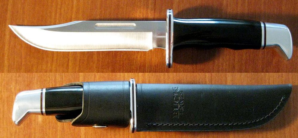

For an outdoor fixed/folder combo for $200/$100 (US), you really can't beat a Buck 119 and Buck 110 (in their basic/standard configurations).
Zw
MTAuanBn
Both are classics and you can buy them for about $150 retail.
