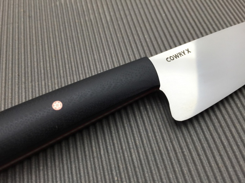

Made a Cowry-X Neocriollo knife time ago ;)
