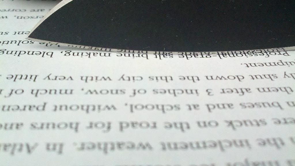

I can get a 'mirror' edge going from a 1k lansky ceramic to green compound on leather strop. Probably not what many here consider a true mirror edge, but I can read reflected phone book text through it!
