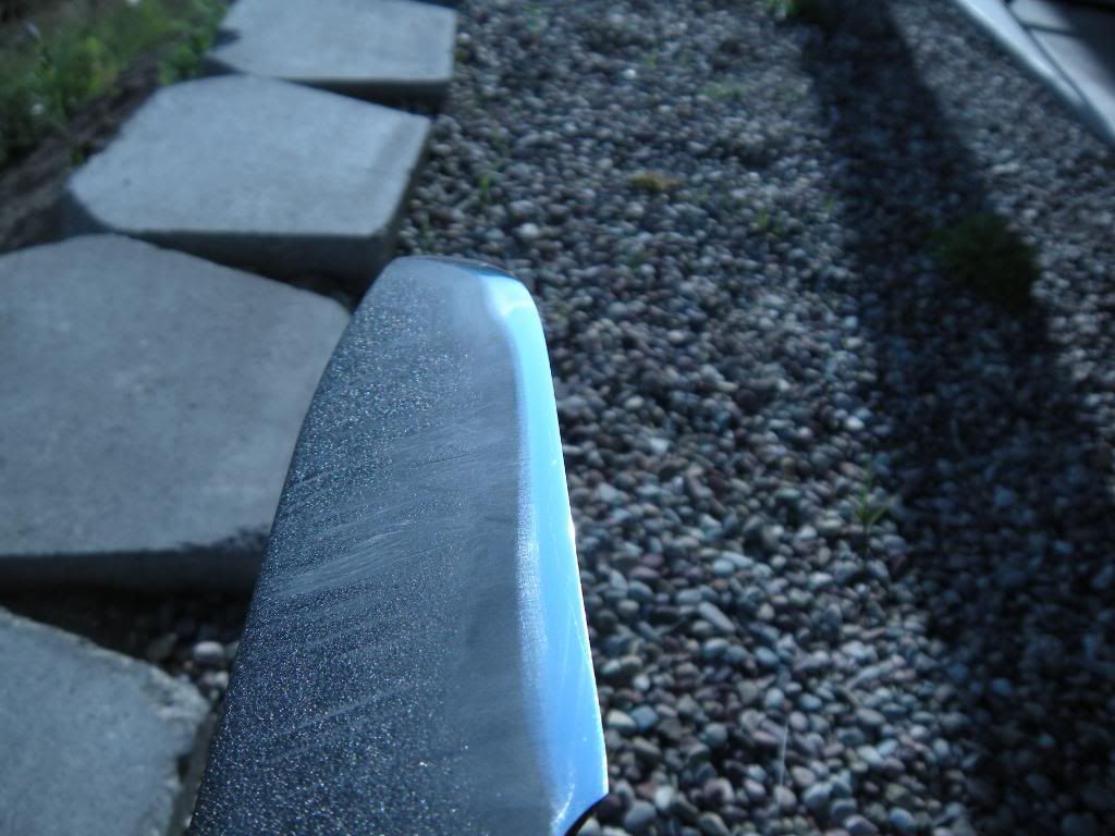

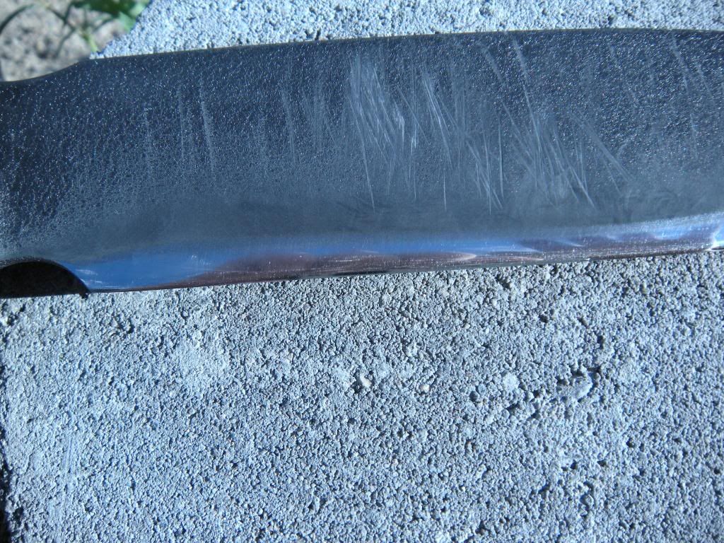

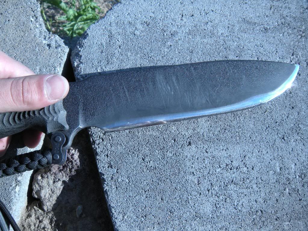

Before: the factory edge was pretty lousy, unable to slice paper and sure as heck not shaving sharp. I was on the verge of giving up on this blade after a weekend chopoff, until a much wiser Hog said "PUT A CONVEX EDGE ON THAT SUCKER!"
And here's after ten or twenty minutes on the belt sander:
All in all, I'm very happy with how the edge turned out. It ain't as pretty as Horn Dog's work, that's for darn sure, but it's darn sharp! Can't wait to put it to a test that's more taxing than grooming my arms :p
looks great. i see you didn't have the same problem of rounding tips that a few of us have had . . . .
Ohhhh yes I did. The NMSFNO wasn't TOO bad, but some of my other blades are pretty awful :thumbdn: I rounded the crap out of my SoD:
That doesn't look so bad.

That looks like a pretty good job you did there MM. What grits did you use? Did you use just one belt and then polish it up with a leather belt or did you do the major reprofiling with a heavy grit and then progress to a finer belt? Just wanting to know how someone else might go about sharpening with a belt sander. I just use a 600 grit and then, if I feel like it, polish it up with a leather belt.
I did some fairly serious reprofiling with a 180 grit belt, then worked down to 320, 500, and 1200, and finished out on a loaded leather belt. I could have probably skipped some steps, but it takes so little time to switch the belt, and I only did a few swipes at each grit, so it was still pretty fast.
I'm used to working through 5 or 6 grits sharpening by hand on a mousepad, so this was nothing!
That's exactly how I started too. After that, I kinda got sick of changing so many belts so I just tried doing the reprofile with a 600 belt and it turned out the same, if not better. I was trying to reduce the number of passes I do since I concluded that the more passes, the more chance of error. Now, I'm stuck on either 400 or 600 grit and a leather belt.

I am very impressed at the tightness of your edge, most convex edges I see, done with a grinder, are much taller.
