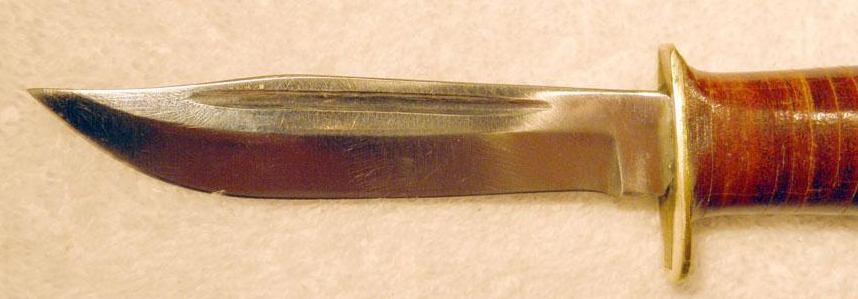

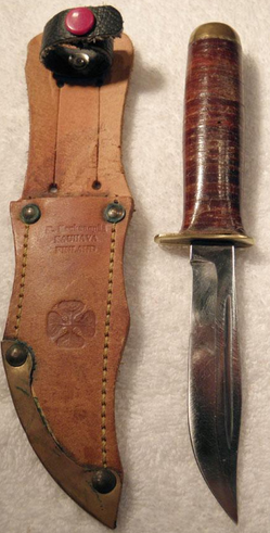

That is the Finnish Scout knife. These days those are made by Iisakki Järvenpää.
I notice that a "Scout" knife in Europe is a shortish fixed blade - usually with a guard.
Finnish official Boy Scout knife of a bygone era and so marked:

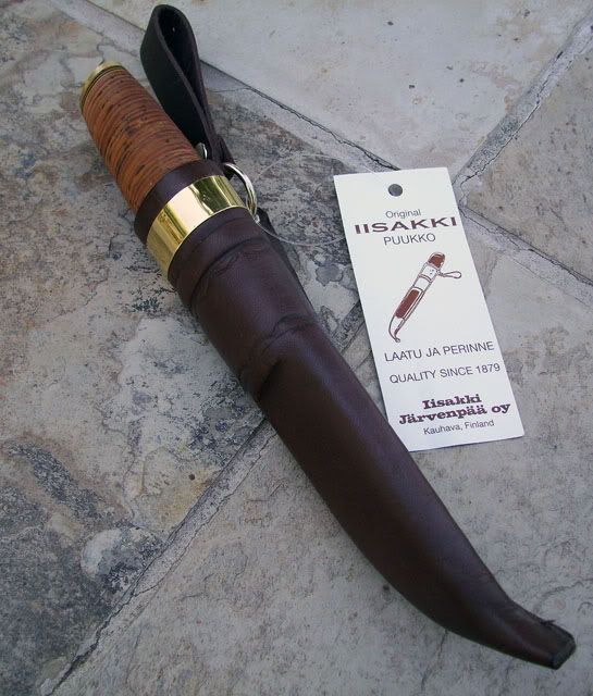

Some Puukko sheath danglers have a slot that allows you to hang the sheath from a button. You can see the slot here
it is described as being part of the Iisakki Järvenpää Aito Puukko sheath here as well:
http://bushcraftusa.com/forum/showt...pää-Aito-Puukko-Initial-Impressions-Pic-Heavy
"There's even a slot on the dangler for a button, should you wish to hang your sheath from a button."
the slot is not visible in the photo, but notice the type of dangler is a flat piece of leather, not a twisted knotted thin leather "string"
In addition, some Puukko danglers are secured by a button on the dangler, after passing the loop under and over a belt. Here is one example:
that type of button is stronger than just dangling from a button on a garment, because the loop is folded over the belt, making the tension on the button half as much as in the slotted Järvenpää dangler. Plus the button is attached with very strong thread, or leather, not regular sewing thread for garment buttons.
Ive seen many other photos of puukko danglers with slots in them, single slots for a button, not the same as double slots for a belt.
here is a double slot for a belt, far right:
although those slots could also be used on a button.
