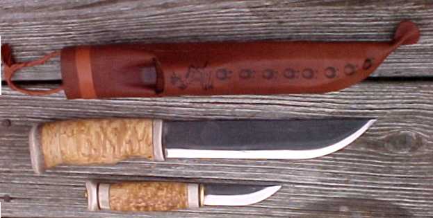

I can see it now. About that, er, nipple. Is the end where the blade inserts open there, and the brass is just a hoop? Or is the end of that fitting closed, so the end-grain of the handle's covered?
Open on the end Tom, so I guess more accurately should be called a ferrule, not a bolster. Still, I generally get a pretty good tang to handle fit, so no sloppy gaps, et cetera. That thick walled brass ferrule is there to keep the handle from splitting should I have to hammer that knife into a tree, or some other such foolishness.
Sarge
Please don't misunderstand my question about the brass ... I think it looks sweet, and wouldn't be concerned at all about the end grain. I've some old chisels from my Dad with pretty much the same construction - they've lasted beautifully for a few decades.
I've sometimes wondered about using a pipe cap as a bolster, but wondered whether it would look too clunky, and about the metal-to-metal fit between bolster and blade. I've never done any silve soldering, nor do I have the tools.
Sarge
Sarge do you leave the ferrule round or do you shape it a little?
The copper ferrules I made for the two kardas on my large Foxy Folly were slightly shaped.
I cut off the length I wanted, deburred them, and then layed them down on the old log I have my small anvil mounted on and tapped them gently with a rawhide mallet.
Makes for a really nice ferrule!!!!:thumbup: :cool: :D ;)
I also cheat on the end as I save some of the sanding dust from the handles and mix it with a bit of epoxy until it looks more like wood than epoxy.
Then I fill the 1/32" void I left for that purpose in the ferrule and shape it to a small angle up the blade a bit.
Effectively hides any goof ups and gives a nice waterproof seal to the end of the handle.:thumbup: :cool: :D ;)
Yvsa, my puukko's ferrule ain't round, it's oval. I padded the jaws of a large machinist's vise with strips of leather, and after I cut a hunk of brass pipe nipple to the right size (yes Andy, I said nipple again :cool: ), I stuck it in the vice and cranked down just enough to yield an oval shape to it. I only do round bolsters/ferrules on the handles that imitate lathe turned pieces (for authenticity).
