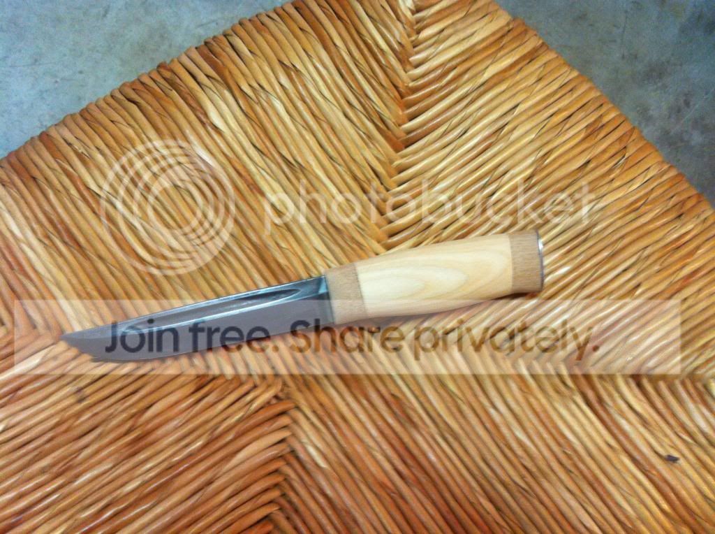

I had this puukko kicking around - the blade is not marked but from some research I have done, it looks very similar to a Marttiini Lumberjack. It was pretty rusty and the edge was quite nicked up so I decided to give it some help. Got the bevel reground and gave it a vinegar patina and now I am on the handle.
Here is where it stands.
So this question is; make it slimmer or leave as is?
If you are going to use it, make sure it fits your hand. Otherwise, give it a few coats of oil as is.
Thanks for the feedback. It does feel nice in my hand - I am not sure how much I will use it but It will be used. I am just curious from an aesthetic standpoint if it looked proportionate...

It looks good as is. I think it might look a tiny bit better if the handle was thinned down just a tiny bit but it's hard to judge without holding it.

Fumbler - I think I might try to thin out the handle just a bit...it feels like it would be a bit "much" if used for an extended period of time.
