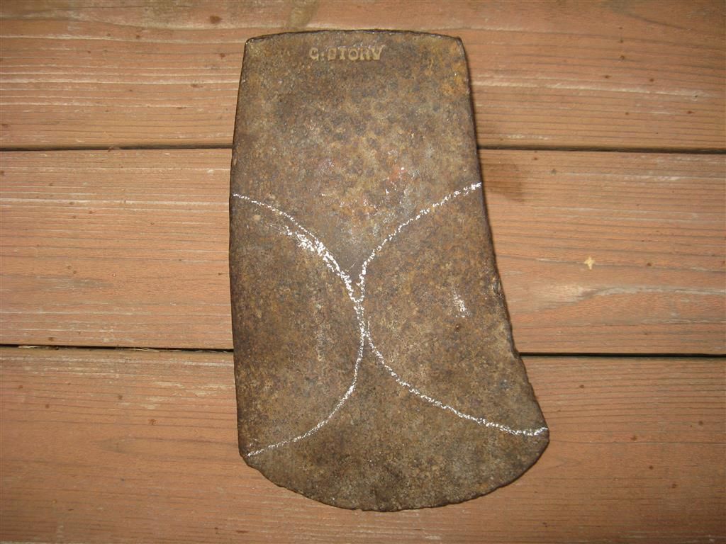

Peterborough Museum and Archives will be receiving the G. Story axe head on Dec 23 when I deliver it in person. Thank you very much Steve Tall for your invaluable sleuthing about the origin of this unique piece. The museum could not offer cash for purchase (which is typical in Canada) but did offer to issue a tax receipt. Tax receipt only serves to reduce year end income taxes and I'm semi-retired and not able to benefit from such an offer but a well-heeled tool collector colleague in Vancouver generously offered to purchase it from me for $250 and 'we' garnered an antique appraiser's valuation of $325. On that basis he has "donated" to the museum. Presumably everybody wins and the axe returns to within a city block of it's 150 years ago origin.

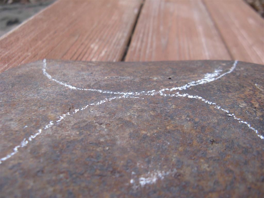

It was suggested that the 5 1/4 lb head is all steel construction (based on uniform oxidation of the surfaces) which would make it atypical manufacture during an era (1860s) when wrought iron was readily available/affordable and steel was in short supply and expensive. I have also noticed that the cheek profile looks suspiciously much like the forerunner of later technology (hot stamping in forming dies) that features 'phantom bevels'. Evolution of tools has always had quiet precedents and I wonder if small town foundry owner George Story might have been an unsung initiator/inventor of this profile. When you view current footage of Swede boutique 'flat-cheeked' axes being 'old-fashioned' hammer forged you can appreciate that scalloped blades and raised centrelines are not at all simple, nor perhaps even economically feasible, to make.

Regarding the whole-steel vs. iron body/welded steel bit I'd hasten to state that it's something of a myth that iron won't pit given the right conditions. Likewise it's possible for steel to rust in a fine and uniform manner without significant pitting. It all depends on the specific conditions that the tool was subjected to. I find scythe blades in all manner of degrees of corrosion, including many that are revealed to be laminated in grinding (where the differing wear rate creates a visible delineation of the weld lines, as well as the difference in spark pattern during dry grinding) that have very pitted surfaces despite their iron cladding. My wedding band was actually forged from an iron 1800's "tire" from old farming equipment, and the exterior of the tire was pitted in varying degrees, yet when cut it revealed a grain pattern in its cross section consistent with wrought iron. It's true that it's less susceptible to initial rusting than steel is, but it's not as impervious to age and weathering as many think it is. Rust is a strange beast that creates different effects under different circumstances. Unfortunately there aren't a lot of non-destructive methods for testing composition of ferrous metals. Unless someone were to grind on it, discover documents describing the manufacturing process, or cut samples from different parts of the head it's not easy to make the call one way or the other, other than to guess that it's most likely for it to have followed the manufacturing conventions of the period and region.

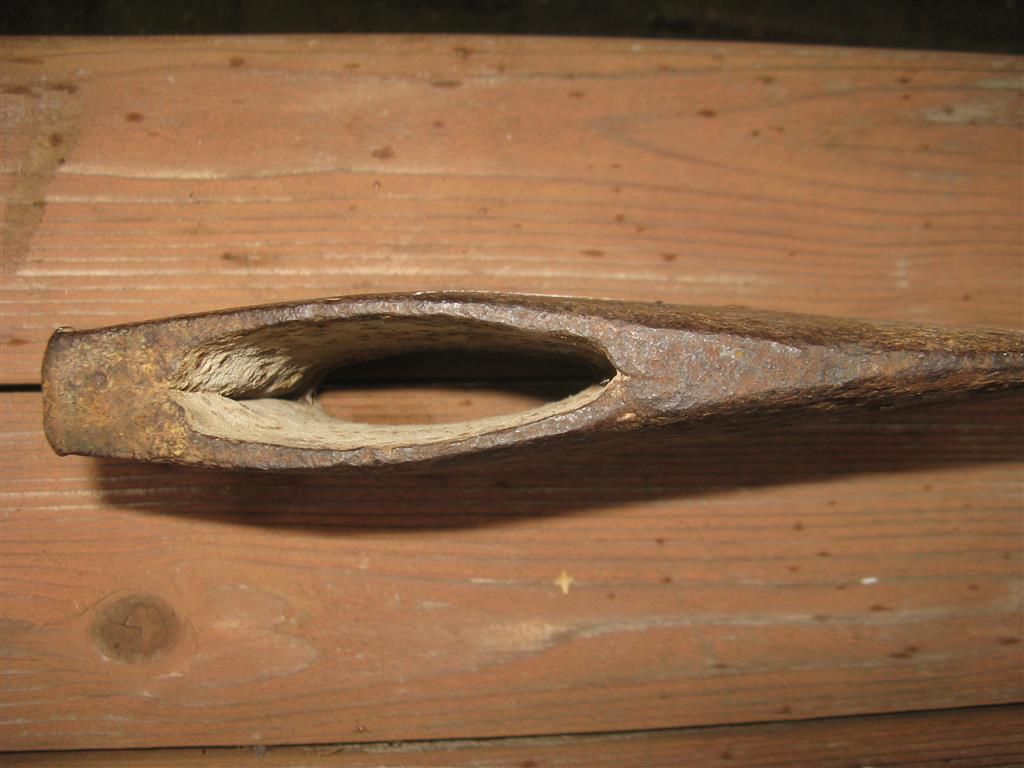

The other curious thing is that the head does not look to have been made by folding over a mandrel but rather is a 'sandwich' of two pieces of metal.
Yeah--it's definitely good that you didn't do anything to alter it! It is definitely an interesting construction. Makes me wonder if the "seam" at either end is a result of slitting and drifting it.
Looks like two straps welded together. Likely an inserted forge welded bit. Poll might be forge welded on as well.
I'd second that.The weld-line going toward the bit,the way it steers off center,makes it likely to be an assymetric weld,very common in the past.
Toward the poll I can make out only that one central seam,but yea,the poll can be welded on,or welded In(a little more common).
Many large-ish axes,especially broadaxes,were a composit,often simply boxing the bit and the poll with a couple of chunks of strap...
FortyTwoAxes,yep,you've essencially got it right about the corrosivity.If i may add a bit:The C content lowers the resistance to oxidation(in an accelerated "artificial" corroding with an etchant the higher the C content-the darker the color;with the WI commonly etching almost white(alloying elements affect this also but to a smaller degree).
But another way that the WI(so-called in the trade,in reality never being any particular alloy by composition,which commonly causes confusion)resisted corrosion was mechanical:WI being refined by folding,welding, and forging back out again,folded a lot of slag into the material(as it was refined further the slag inclusions got thinner and thinner,but of course never really went away).So that the object made of WI corrodes to the nearest slag layer,where,slag being Si and other non-metallic junk,the corrosion slows,or even stops.
That is the why for WI being spec'ed for the Navy anchor chain,the very low C plus those mineral layers offering a little more protection.That.of course,is also the reason that much corroded WI gets this "wood-grain" pattern of texture.

Lieblad,now that you've said that i can see that it's indeed possible,a nasty drifting ordeal gone wrong(maybe the forge forming a nasty big clinker,the heat becoming lousier and lousier...:)...then trying against all reason to forge the mess back into the semblance of decency...
But i don't know,even in the photo you can see the crack towards the poll going almost all the way...Doubtful that someone let a screw-up like this out of their shop...Hope that it's a weld:)
CAT scan works very well,too,you can see lots,inclusions,voids,all the stuff we normally not wanting to see in our axe-heads...
The museum now has the axe. Interestingly while touring their exhibits I found an identical shaped (but without (or illegible) stamp by virtue of being considerably more rusted) head in the display of Empire Loyalist provisions. British Colonial citizens fleeing from the newly formed Republic of U S of A in the early 1800s were granted 100-200 acre land parcels in southern Ontario (then called Upper Canada) and rudimentary provisions (bag of nails, crop seeds, window glass, clothing fabric, tools, bags of flour etc) in order for them to build shelter, prepare for winter and start land clearing for farm operations. It said on the display that the axe head was British issue.
The profile of the Story head is entirely unknown to me and not one common to n. American manufacture so it may be that George Story copied the design (and added the cheek scallops) or maybe the museum curators mis-identified an artifact that was donated by a local citizen who believed it to be of earlier manufacture and authentic British issue. It'll be interesting to see what comes of this.
