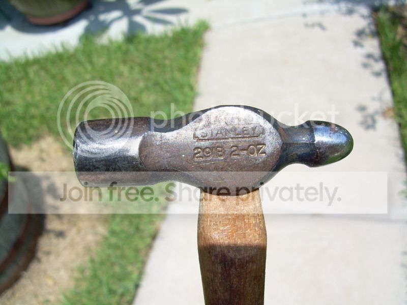

So I'm the kind of guy who would rather make my tools than buy them (read that as $broke!), and I've been needing a lighter weight jewelers hammer, something in the 1-2 oz weight range. I have been using 6oz and 8oz ball peins I found at the flea market, but when working with ivory and unstabilized burls I still pucker at both ends when peining 1/16" pins!
My plan is to use a high strength bolt as a head, I can get them for free from a friend who owns vacant industrial/manufacturing sites, and turn it down then heat treat if possible, or just work it hard if I need to. What size radius should I use for the ball end? I was thinking of either 1/8R or 3/16R would be about right. Or should I try for an semi-eliptical shape?

I made a couple out of damascus for some friends at 2oz each,on the peen end they were simi-eliptical 5/16" diameter about 3/8" long with about an 1/8" radius on the end.Did mine by hand as I'm not that good of a machinist.:o

Here is a pic of my 40 year old Stanley 2 oz,it's what i patterned my hammers on.2"OAL hammer face 1/2" dia.3/4" wide at the eye,1/4"X1/2" eye.
Hope this helps,or you can buy a 2oz from Rio Grande for 10 bucks:D

High strength bolts are usually made of 4140 ,though offhand I don't know what the hardness specs are.Certainly a good steel for hammers.
B7 and B16 bolts have .37 to .49 carbon and about 1% chrome. B 7 tempered to 1100f and the B16 to 1200f. Spec for grade 5 and 8 bolts have between .28 to .55 carbon difference being HT
