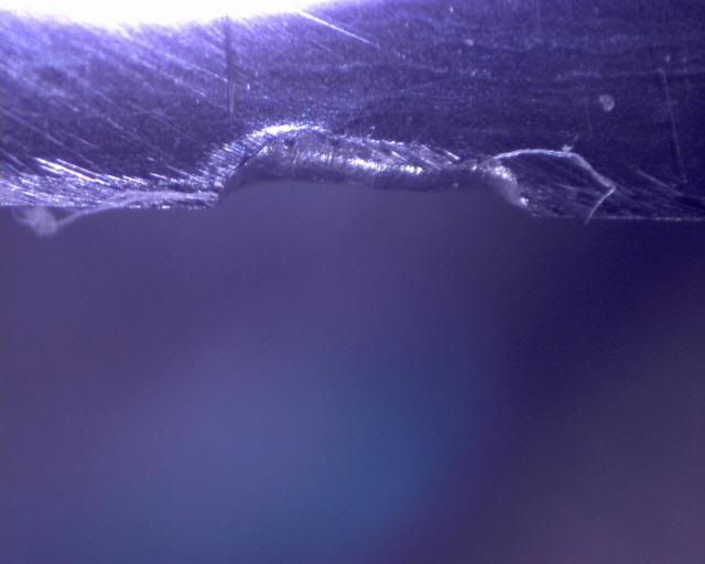

I think its only 100x and not 200 like I said above but either way I think it a good shot :D

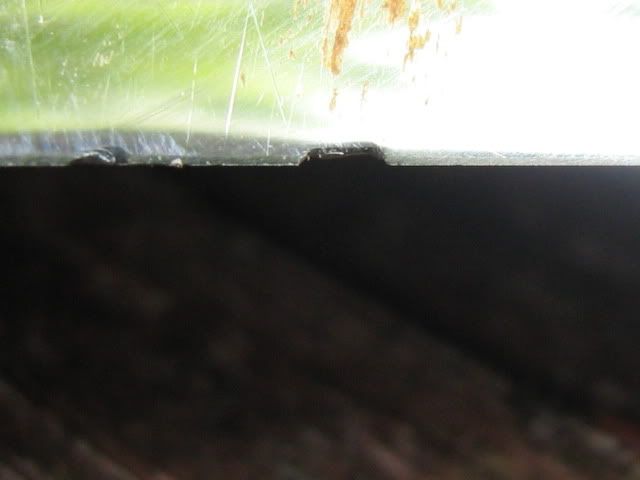

I was splitting a 2x4 with my Regulator and hit a large metal staple. Didn't cut the staple but did a number to the edge, I was surprised too because it was a thicker convex bevel :confused: The secondary bevel you see is from touch-up while camping and unfortunately removed the excess deformation.
Not so close up.
on the regulator, the secondary bevel did remove a mashing/rolling/bending of metal around he damaged area right? I would expect sr77
to deform a fair bit before sheering or chipping away, where I'd expect sr101 to be the one to just chip away without deformation if any of
them were likely to do it at all.

remember, I tore a chunk out of the edge of my ASH chopping through that rusty chain...
Jerry wrote that it was due to lateral twisting as I was chopping, IIRC. In other words, had I held the knife straight and batoned through the chain it wouldn't have done that, but because I was swinging full force like a mad man, maybe 20 times, I was twisting it slightly some of the time.
I'll dig up the photos in a bit.
the chain:
the chunk:
a close-up:
and Jerry's comments:
Based on how the knife was used (loved), I would venture to guess that the missing piece of the edge was most likely damaged when it was wedged into a link and then torn out by the chain's movement during chopping! Had the chain link been stationary there might have been some dents but I doubt that there would have been any tears or rips in the edge. When steel chips, it almost always looks like chipped glass. If you look at the close-up pic of the edge, you can see where the steel was torn around the upper edge of what looks like the chip. This is typical of INFI under this type of impact on steel, where the steel continues to move after the edge is wedged in the steel. Whereas, most other knife steels would have chipped out dramatically along the entire edge, INFI simply dented and was ultimately torn out in just the one place. Very cool!!!
I held nothing back, and beat the f--- out of it against that chain. all in all I think the knife held up amazingly well, and, of course, Jerry and crew warrantied the knife even though I was monkeying around.
Gotta love it.
