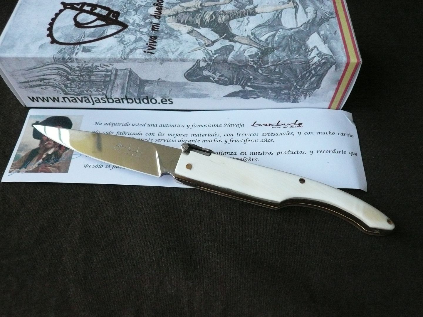

Luis Vergara navajas seem very good quality,hand made and of modern materials too.Have one of those on order too.
I will have to try one of those Barbudos, they seem to be very well made. Try Cudeman, Esposito, JJ Martinez, Celaya, old Aitors , Muela and Vergara, all good stuff. There are many quality makers in Spain, so they have to be good in order to compete with each other.

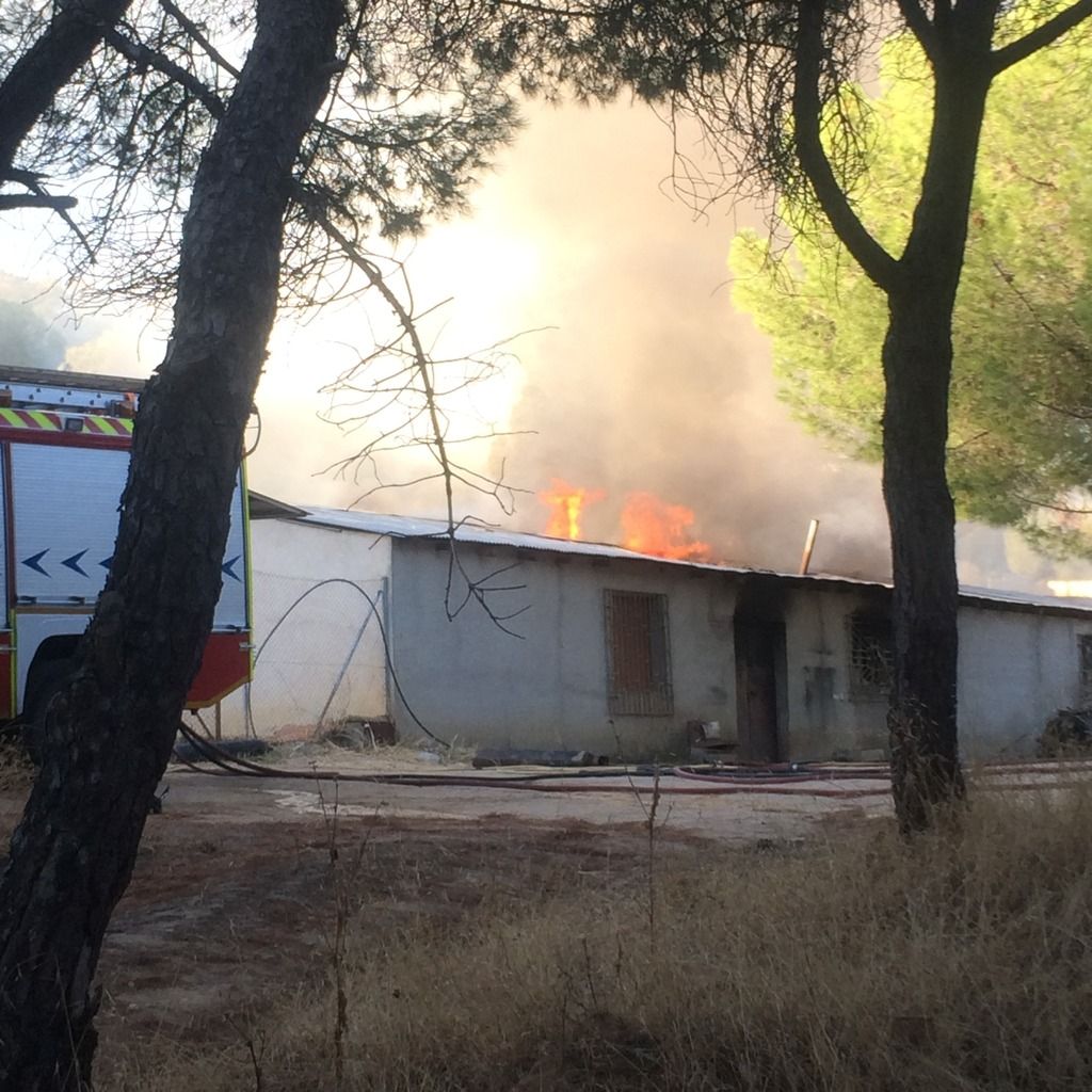

That's horrible news! I hope no one was hurt in the fire.

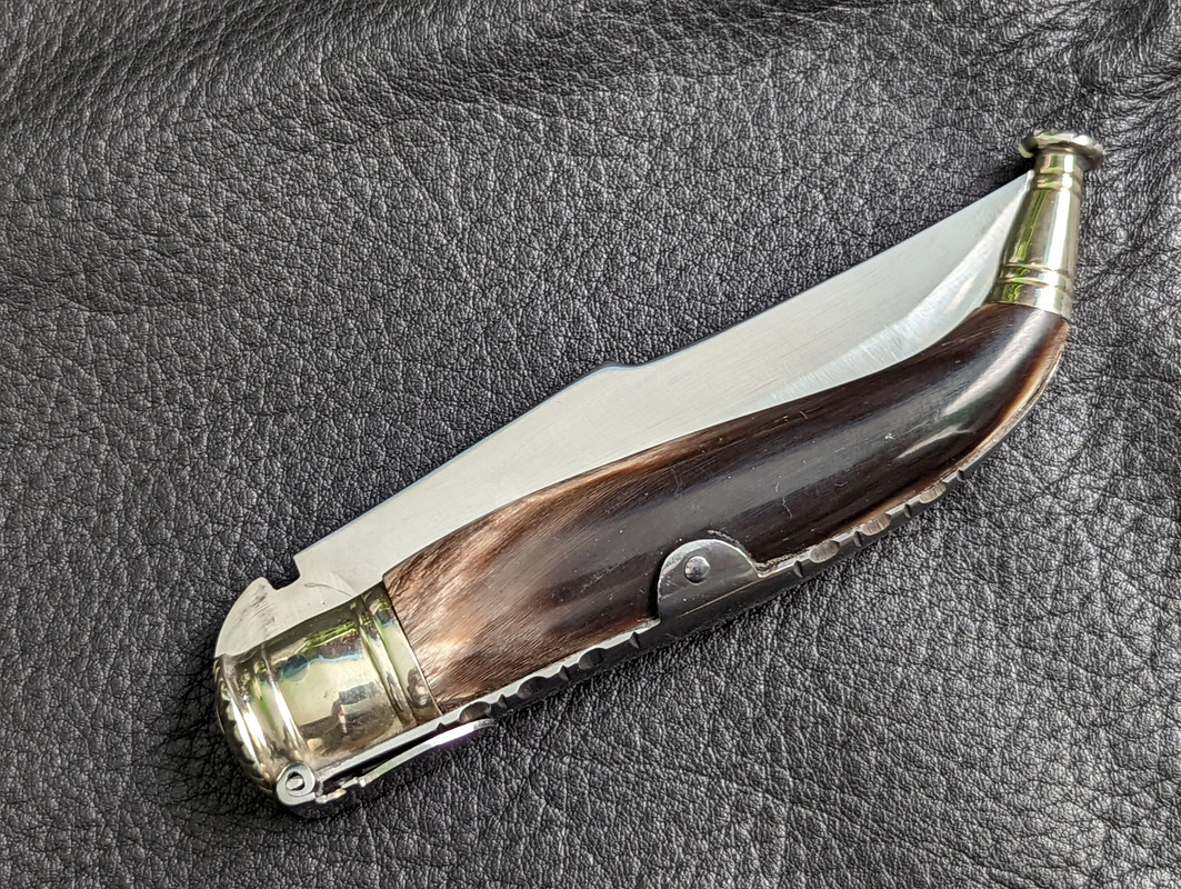

My first albaceteña was this model by Exposito in bull horn, blade of around 3.5" in 440A. When I first received this knife, I was pretty underwhelmed. These navajas do not have any type of spring, they are basically friction folders that lock when opened.

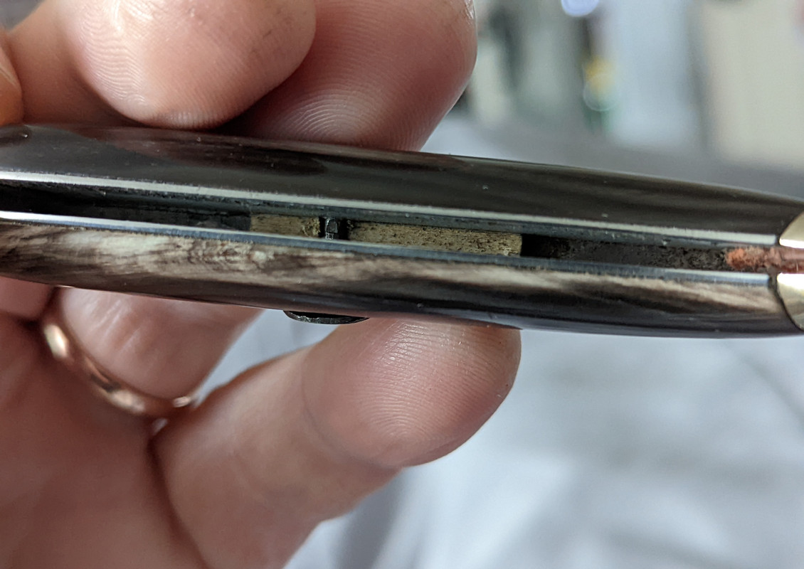

One annoying thing about all of these is the lack of any kind of blade kick or stop to prevent the blade from contacting the inside spine of the handle. In the following picture, you can see the little piece of wood that was used as the spacer for the handle where it is pinned. On the right side, you can see a little bit of what I think is leather, to keep the blade from contacting any metal. I have since added a strip of leather inside the blade wells of all of my navajas.

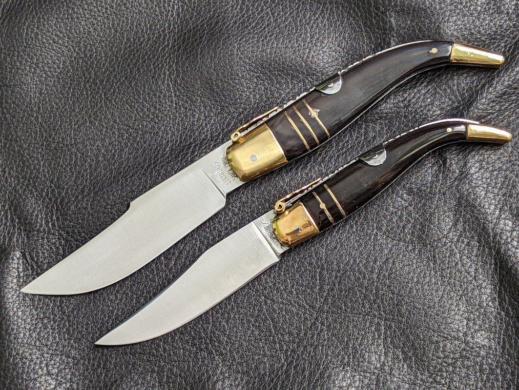

Next up is a pair by J.J. Martinez. The top one is nicknamed Sancho, which I was told is the name of the hero of an old Spanish TV show, who would save the day with his navaja. The smaller one was the worst of all of the navajas I have acquired, but part of that was probably because it looked like it had been carried for a year or two already. I sanded and re-finished it because it was full of scratches and horn was completely dull. Probably handled a lot over several years of being in a store.
Sancho is a pretty big boy, next to a 110. Almost half the weight of the 110 too!

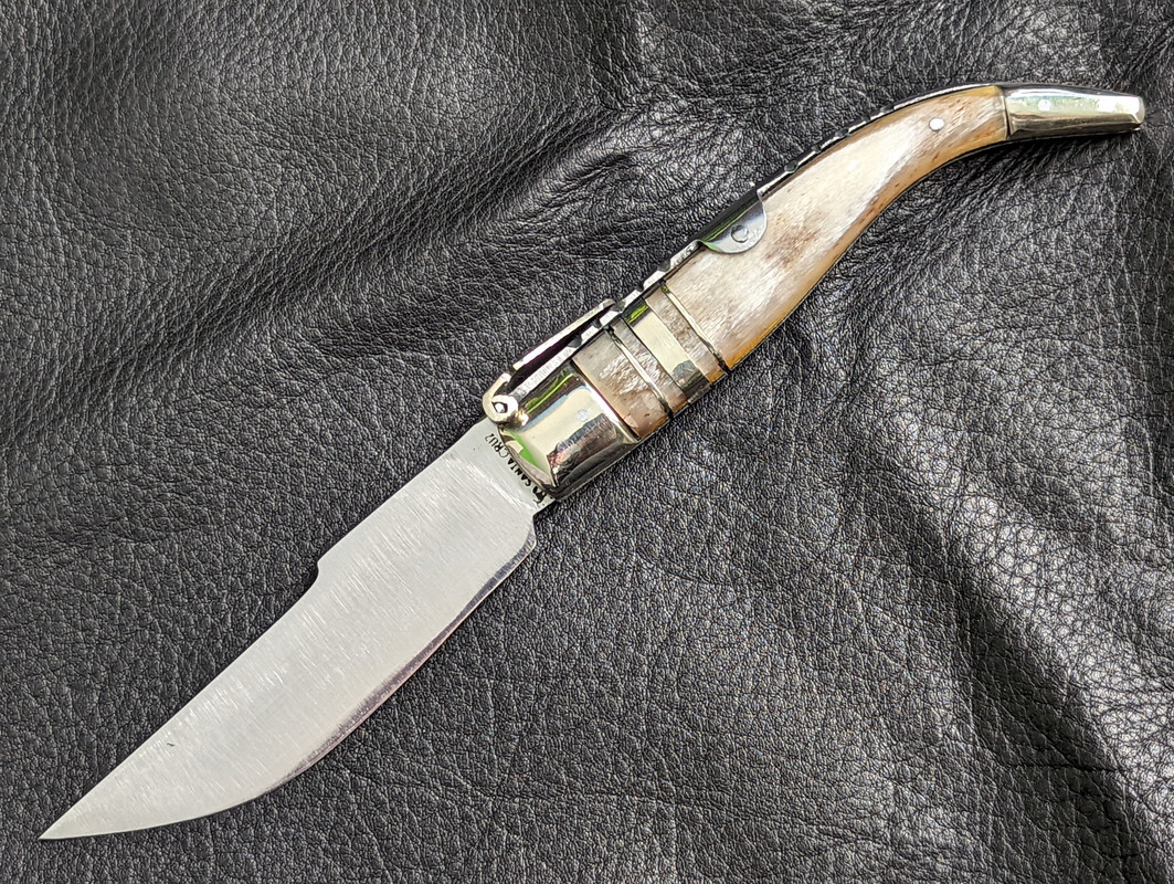

Next is one by Francisco Valencia. I had ordered it in carbon steel, but arrived with the dreaded inox stamp, so probably 440A or the equivalent. This one is the nicest of the bunch, just ahead of the Exposito. In fact, my experience has been that Francisco Valencia is one of the better brands, though not without faults as they are all still a bit rough in fit and finish. Small gaps in the handles, a bit scratchy in the finish and joints between all of the parts could be smoother.

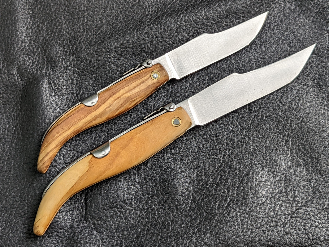

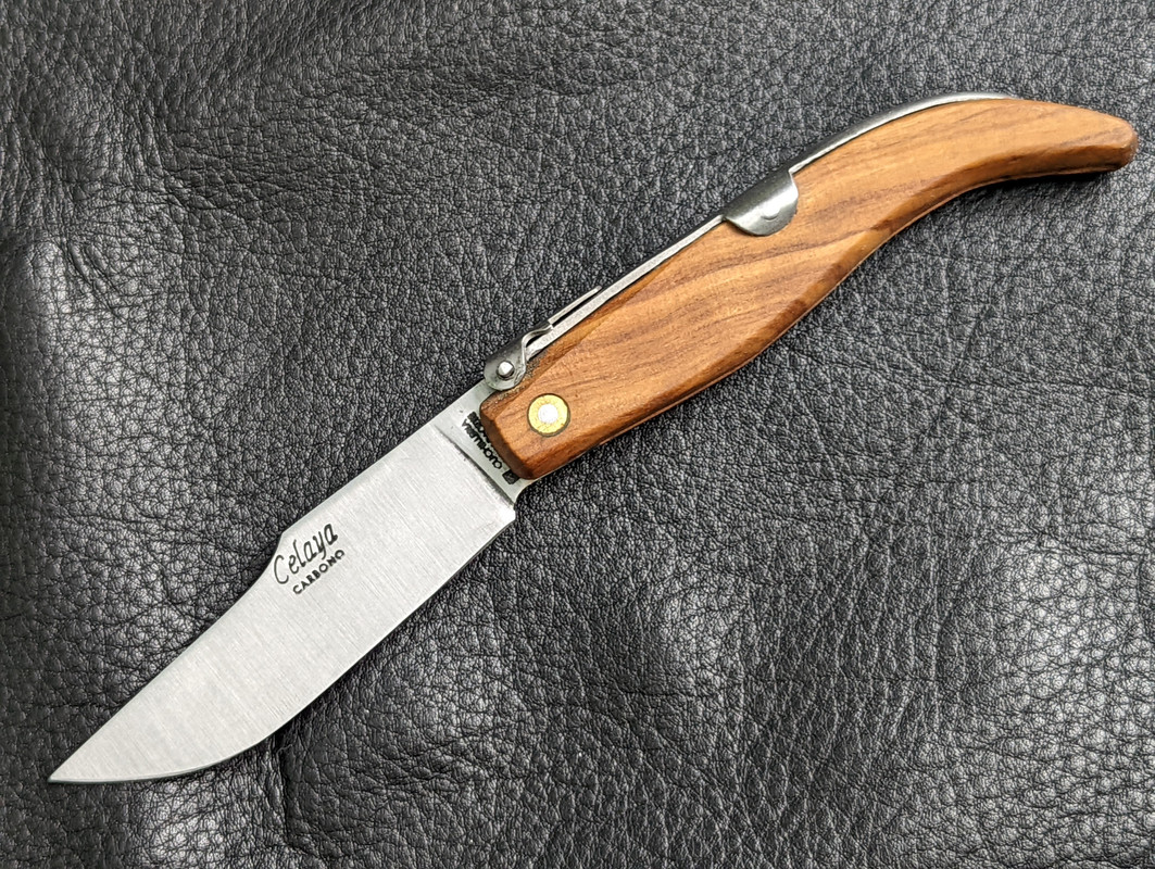

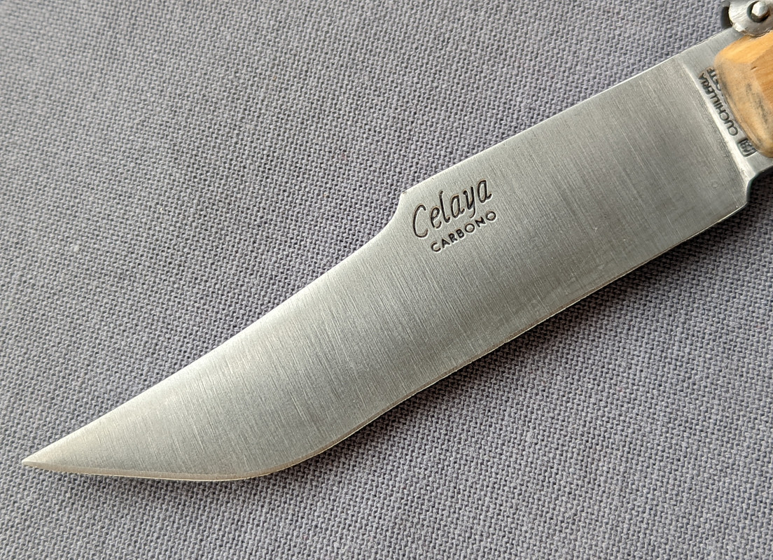

Next we have the super budget friendly albaceteña's by Celaya. The pallanquilla's (the metal lifter flap) are very loose on these and just flap around. The finish is incredibly rough, but for $25 and a very unique look, they are worth it to me. Also available in a drop point and stainless option, these are carbon with olive wood handles. The smaller ones have an approximately 3.25" blade and the larger, just shy of 4". These are incredibly light and what I would call little big knives.
The smaller one, fresh out of the bag

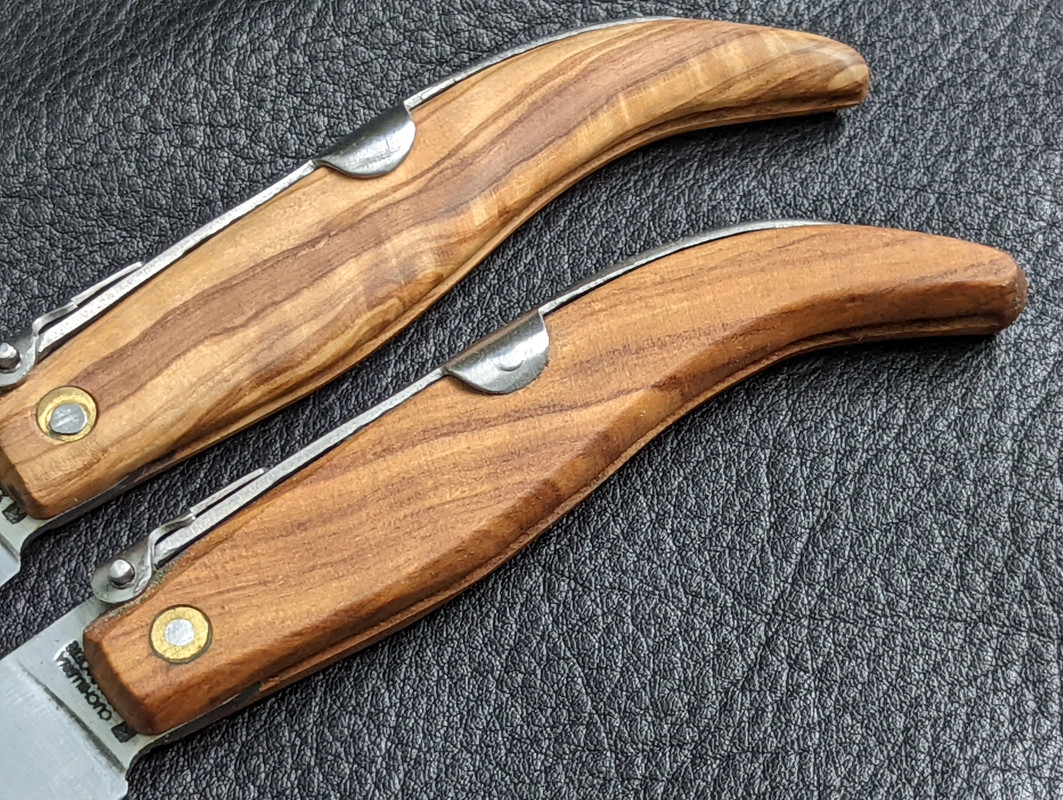

I reshaped and smoothed the handle of one to make it a little nicer.
Smaller one with the bigger one, which I also rounded and smoothed.
It had a pretty crooked blade grind which was fairly easy to correct.

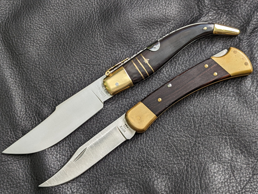

The machete is one of my favorite Spanish patterns. I was really disappointed with the first one I got, this Exposito in ironwood and San Mai VG-10. I figured it would be decent since it wasn't the cheapest. I was wrong.
This one is a slip joint, overall construction is decent, but it lacks any type of kick, so the blade sits on the spring, causing a dull spot at the tip and in the center of the blade. Finally corrected it with a strip of leather in the blade well.

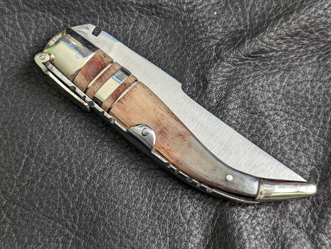

A few years later, I decided to try the pattern again because I love the look of it. This one is a J.J. Martinez with tapitas or caps that are soldered on the ends of the bolsters. I think it was around $35, and for that price it's not bad. Carbon steel
Francisco Valencia in cocobolo and carbon steel. This one was very inexpensive as well. When I received it, it was pretty caked in polishing compound so I cleaned it out with a toothpick cleaning patch and rubbing alcohol. The wood bled terrifically, which is odd to me because I've worked with cocobolo before and it shouldn't do that. I'm guessing they put some kind of stain on it. When I was done, it doesn't continue to bleed on my hands, but it made me wary of ever buying a wood handle from this brand again. Overall, for the price, it is a decent knife
