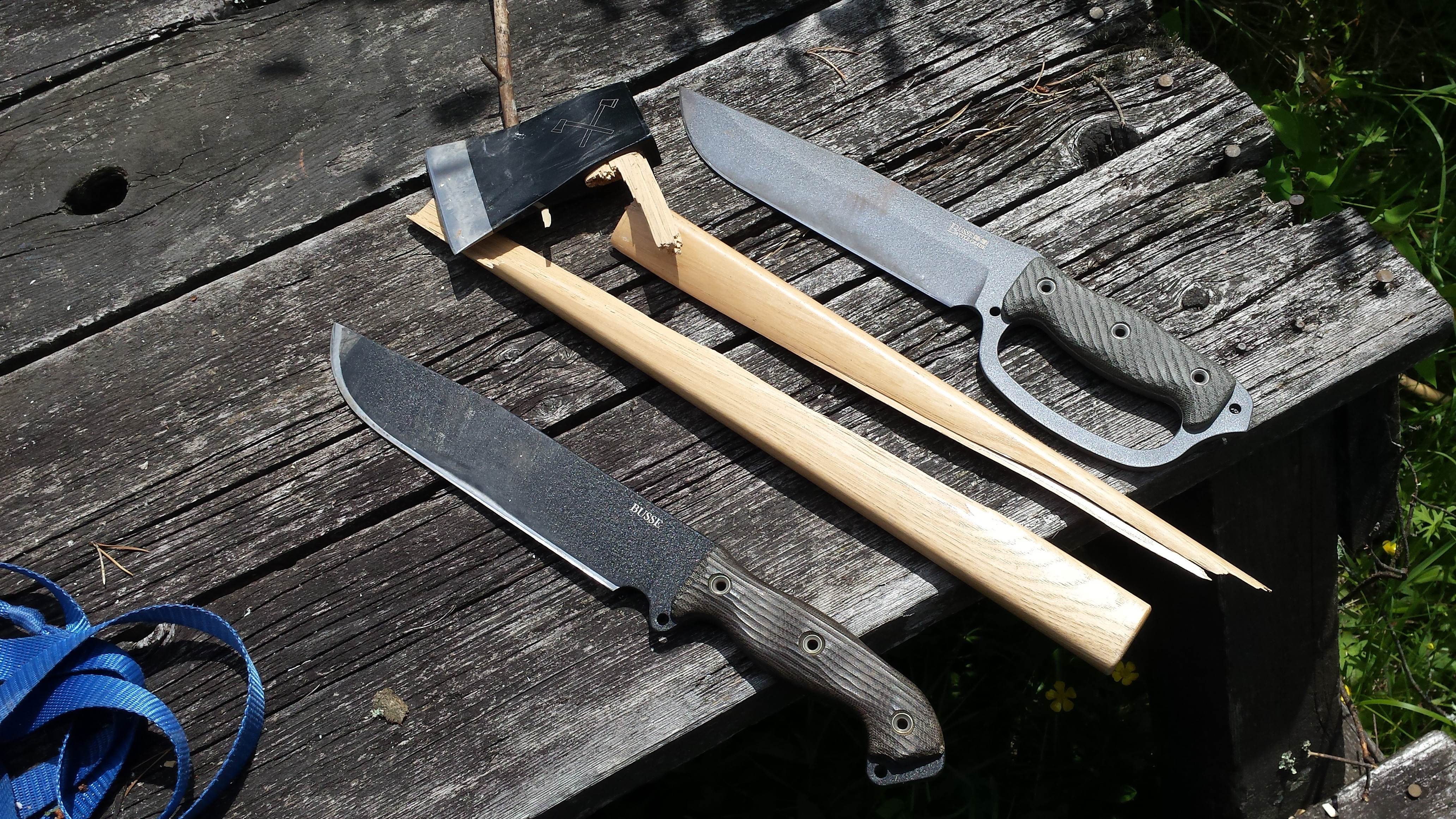

Have owned this gang hatchet axe for around a month, have used it once before, "had" high hopes for it as the head cuts real deep into wood, thin grind, but the wood is weak. 2nd time took it out was today and this happend.
Any chance can get a replacement Cold Steel? I also own a trailboss, haven't used it yet. Very worried to now. As wood is identical and not that much thicker. The tree I was chopping through was 8", no knots, no nothing. Have chopped through thicker trees with .18" knives with no issues. First time an axe has ever broke on me. I saw a video on YouTube of a guy also breaking one of these and chalked it up to the size of log he was trying to split, but now seeing they are not very durable at all.
A. Can I get a replacement?
B. Are these just novelty axes and not supposed to be used outdoors much?
Anybody else have a CS axe break? Do they make any descent models?
As cautionary tail or cause it may get more responses? Im jjst trying to see what CS can do for me and asking if this is usual? I'm getting rained on now in a tent so more pics will have to wait.
Cold steel knives I have never had an issue with, like all have had and still own a few, but this thing broke with very little ease. Defect or is this supposed to just be a novelty?
Ouch. I would say CS would most likely replace it, or at the very least send you a new handle.
Not that it excuses the break, but I was under the impression that the Axe Gang Hatchets were more of a martial weapon, and not so much an outdoors tool, just IMO.

That design is a fighting design. You could bore the head out a bit more, and get a heavier handle.

I also have a trench hawk that have beat the living crap out of and hasn't broke, and that is mall ninja/novelty as #%$!. It's a hatchet, I assume I can use a hatchet as a hatchet. It feels like a hatchet. Really did have high hopes for it as light camp hatchet. Did not, nor had any intentions to use it roughly but breaking the way it did with light chopping was crazy.

that's about the 5th axe gang hatchet I've seen break in the exact same way at the exact same spot doing the exact same job..... I'm starting to be inclined to believe that they were not ment to use on wood but rather as martial arts weapons......weird stuff huh?

That sort of split where the grain seems to blow apart seems to happen more often in wood that is dried fast in a kiln versus a slower process. I bet there was just a bad batch, but nobody really notices because a lot of those hatchets are "martial" or wall-hangers and don't impact wood. This will happen on tools you get from the hardware store, too, and it's not really a reason to retire the axe or distrust the model. Chalk it up basically to bad luck and rehang it.

It's a natural wood handle. Yes it's going to break at some point. It's regular maintenance on an ax that's being used.
When you get a new one, I bet you could reinforce that area of the handle by wrapping it tightly in some leather cord. Soak the cord, wrap, and let it shrink over the wood as it dries. :thumbup:
