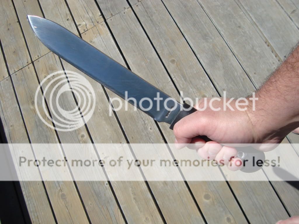

I have a Golok, a Kumunga, and a recently obtained the Varan.
I have used the Golok and Kumunga a bunch. They have taken a ton of abuse and I love them. This is my Kumunga (my favorite of the three):
The sheath works great. I like the easy access of the pouch style. I am used to Kydex and Spec-Ops sheaths but I did not want to buy a sheath for it that was more $$$ than the knife itself.
