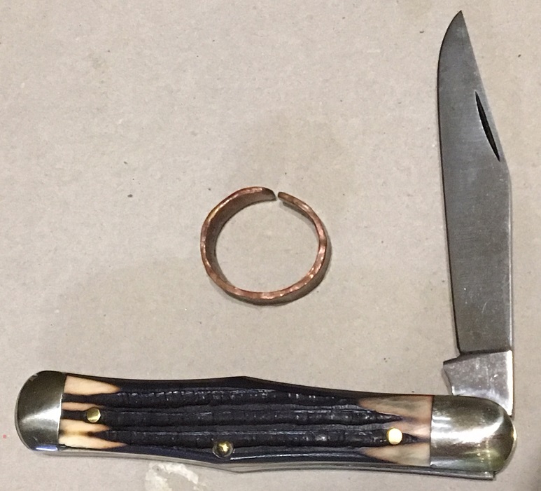

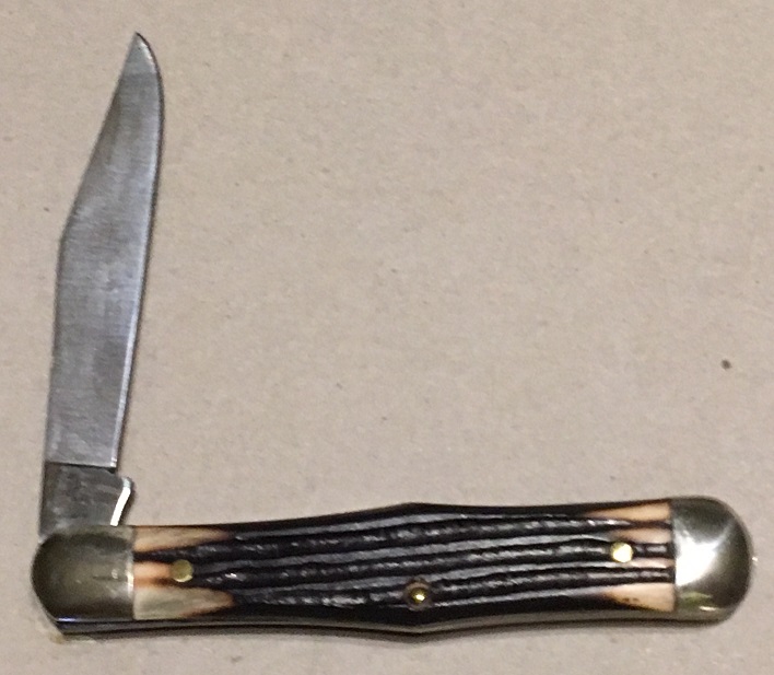

what do yall think of this one? i dont remember where i got it. probably a flea market or antique shop.
could it be a real queen or pakistan special? it's surprisingly pretty well made.
I believe I have one just like that. From what I recall of what I read a few years back, there were a few years when Queen wasn't stamping the tangs at all, and I don't think they even etched the carbon steel blades.
Queen didn't use tang stamps from 1961 to mid 1971. They just etched the Queen name/logo onto the blade, and sometimes etched the pattern # also. From first looks it seems good. Can you tell if the handles are real bone or delrin? I think Queen made a switch to Delrin material styled as imitation Winterbottom during that time period.
I've never seen a tang stamp reference for any brand of knife that was 100% correct. There are always variables. Things like who did the stamping, the condition of the stamp, which stamp was used, the size of the tang all play, how well struck the die was, etc. all play into what the tang stamp looks like. Also, many of these charts are made up after the fact, sometimes years later. Often times the charts are composed by collectors who may not have any access to records from the manufacturer, so inferences are made, which become 'fact' after a while.
In recent years Buck and Case have had easy to date tang stamps. They both do a pretty good job, but there are still problems now and then, and their older knives are often hard to date. Many makers were haphazard throughout their lifetime. As unlikely as it may seem to us, most knives produced over the years were utilitarian things, so accurate dating down the road wasn't a great concern for manufacturers.
Lastly, you can never say never when it comes to knives, or so it seems. Every collector who has been at it a while has an oddity that shouldn't exist, but is the genuine article. Often times parts were found in dark corners and got made into knives. Or, warranty repairs mated parts that wouldn't normally go together.
