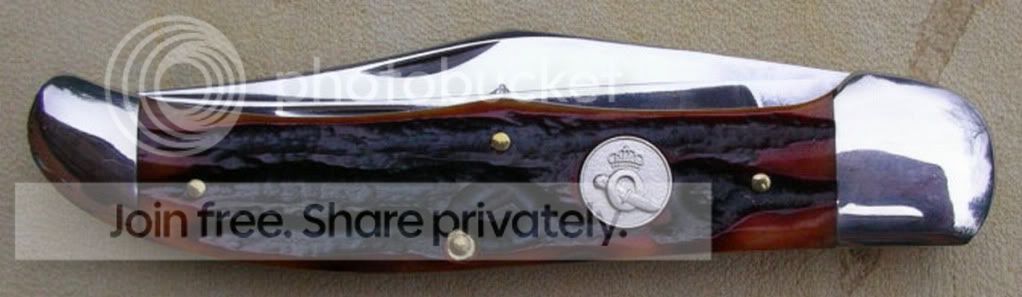

Queen Cutlery Amber Carved Stag Bone Folding Hunter. D2 Steel.
This has caught my eye recently...
I was looking for a Single Blade Hunter Pattern. I liked the look of the
Case Yukon, and the
Case Arkansas Hunter,
However I was not quite ready to sell off a kidney to acquire one.
Anybody have one of these? What's your experience?
Any other recommendations for a large single Blade Hunter?

Based on experience with Queens that I do possess, I would expect to have to change the edge bevel. The ones I have bought have had an edge, but the edge angle was ~25° per side, which does not make for great cutting. An extended session with either a Norton India or a DMT Extra Coarse stone will likely be recommended.
But the fit and finish on all of mine is very good. The springs are firm, but not nail-breakers. The Amber stag-bone is outstanding.
If you don't mind fussing a bit with the edge, a Queen makes a great knife.

Jamie says he did re-profile his D~2 steel blade Folding Hunter on a Coarse 325-Grit Diamond 'Smiths Brand' Stone-Hone to give the proper cutting edge.
He says he uses his knife for everything from food preparation to all kinds of rough working chores. He carry's his knife in the right hand back pocket every day.
He says he hopes this helps you all a little.

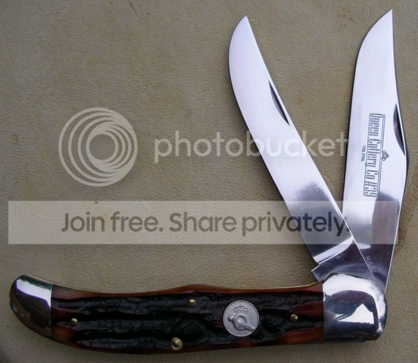

I have the 2 blade version:
seems well made; no blade play. but as already noted, would need considerable work on blades to get a good cutting edge. always amazes me why Queen does not do this at the factory.

I carried it on and off for maybe a month. It wasn't a huge problem or anything, but i tend to mess with my knives a lot and mine had some really nice grooves like the one rproctor posted. So i would constantly be rubbing my thumb up and down the knife only to take it away a dark red/orange color. Just got on my nerves so I sold it.
