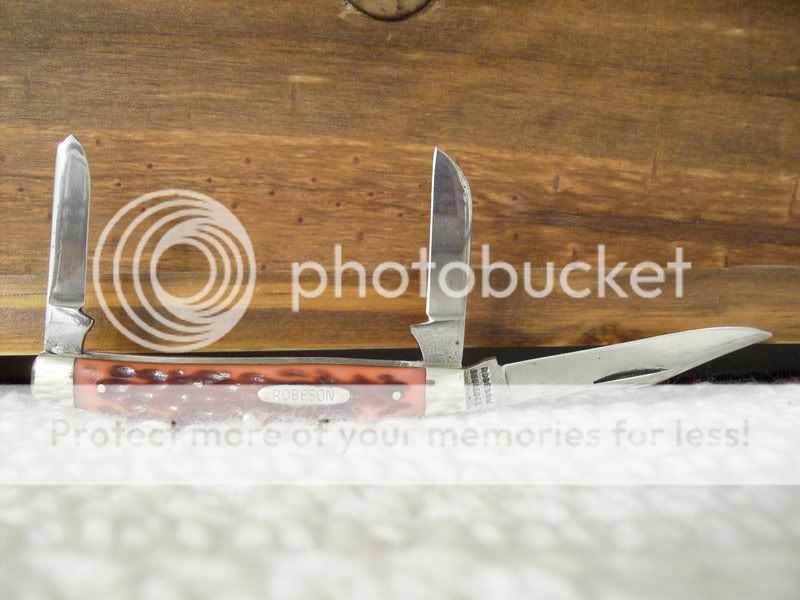

Question though...did Queen make Robeson knives with delrin handles? or is it an older one?
I have seen modern Queen made Robeson knives in bone but not delrin.
Truthfully I don't know if it's an old original Robeson or a Queen made one. It's pattern #633295
The heat treat is not bad AntiqueKnifeFan it's mostly in the edge geometry. I've thinned it down some now, and the perfermance has gotten better in cutting and ease of sharpening.
Peter;
Thanks for posting. That is an older one. It appears to me to be one that was actually made in the Robeson factory after they went to strawberry delrin handles, late 50's to 63.
After that Camillus made Robeson pocket knives through the mid 70's...but they used their own (Camillus) tooling so the patterns are somewhat different.
Thanks knifeaholic! I was going to make a present out of it to someone special but if it's an original Robeson it will have to stay. I had (??) to it being a Queen since the quality is just a little below the bottom of the line Queens. So I don't feel bad about posting this and beating up slightly on Queen's 1095, I'm certain that my Marble's Cattleking Stockman has 1095 secondary blades in it. It's 1095 spey and sheepsfoot blades are well heat treated!!
