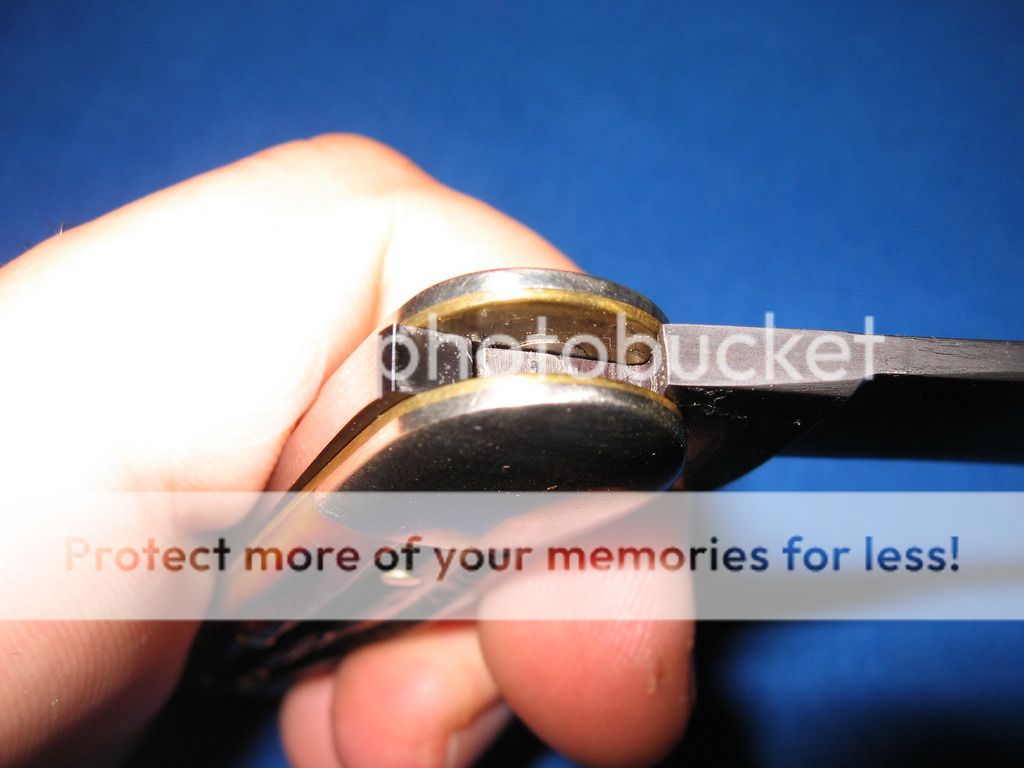

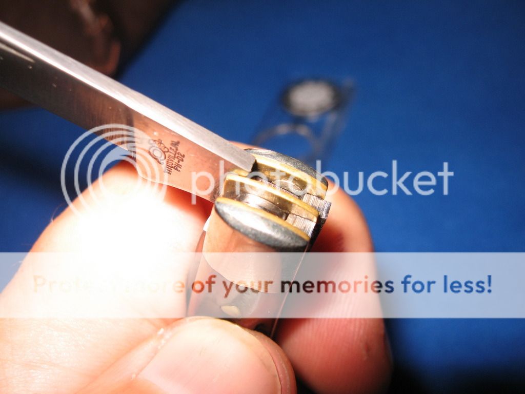

Of all the traditionals i've tried, only these two queen knives, a canoe and a serpentine jack, appear to have some sort of steel washers. Anybody knows if these are washers or is it the bolster design that has some steel in it around the pivot ?
I have a Canoe with the Birdseye Maple covers and it has the bushings? but they are not as big as yours. It looks like your blade is half open, I have to go 3/4 to see mine. The tang still hides them at 1/2 open.
I also have a mini Trapper with them. Still look smaller than yours though.
After seeing this post I looked at my Queen City Copperhead, it has that feature also. Can't tell for sure if it is a bushing or not.

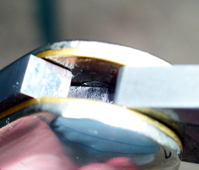

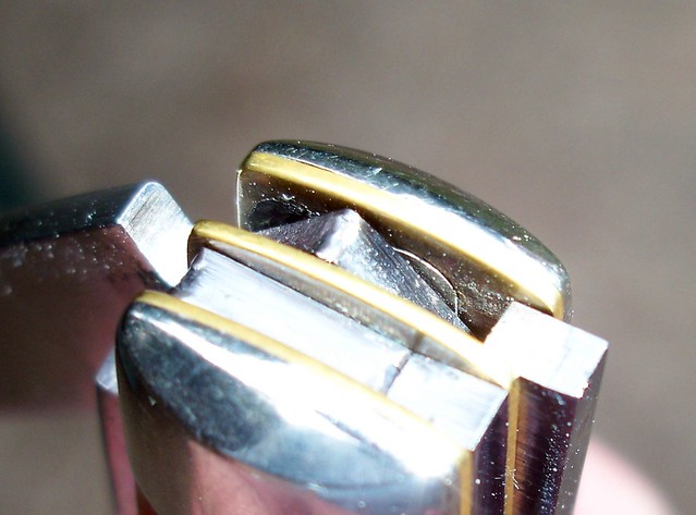

Yes, thanks for pointing this out. I dug out my serpentine jack and saw the same bushing. I'm very curious as to what it's made from. Nickel? Steel? At any rate, digging this knife out will encourage me to put a useable edge on it.
Very interesting link, Ed. :thumbup:
I wonder if maybe Queen has 'relieved' (milled) the back side of the bolsters to create that bearing surface, which appears to stand just a bit proud of the inside of the brass liner. That would appear to have the same effect as the liner milling in your link, to minimize contact between the blade tang and the inside of the liner. I've always been impressed with the glassy smoothness of opening/closing on my Cattle King, and that 'raised' bearing surface could have something (everything) to do with that.
I'm sure it's also possible that what we're seeing is just an actual washer placed into a cutout in the brass liner, itself a bit thicker than the liner, which could accomplish the same thing (might be less expensive to make, too). The 'washer' looks like it could be steel to me (and the bolsters are nickel). From a wear standpoint, a steel bearing surface against the steel blade tang might make more sense. I'd think the steel tang could wear down the bearing surface quickly, if it were a raised (milled) extension of the nickel bolster. Something new to think about; hopefully we'll get some more input here.
I think what you are seeing is the "tommy" pin. It is a rivet pin forged or cast as part of the bolster, which goes through the liner or scale and is peened inside.
The pivot pin may or may not go through it, creating an illusion of a bushing. If you move the blade as you look at it, you may notice it is not at the center of movement like the pivot is.

The tommy on a Swinden key system is completely different from a "standard" tommy pin. A standard tommy is not designed as a keyhole arrangement, but a permanent fastener, filling it's hole tightly.
I feel like the ones on mine are definitely not centered on the pivot pin.
So you're saying the "tommy" pin would be solid and is used to secure the liner to the bolster (or vice versa) by peening it into place before the pivot hole is drilled?
