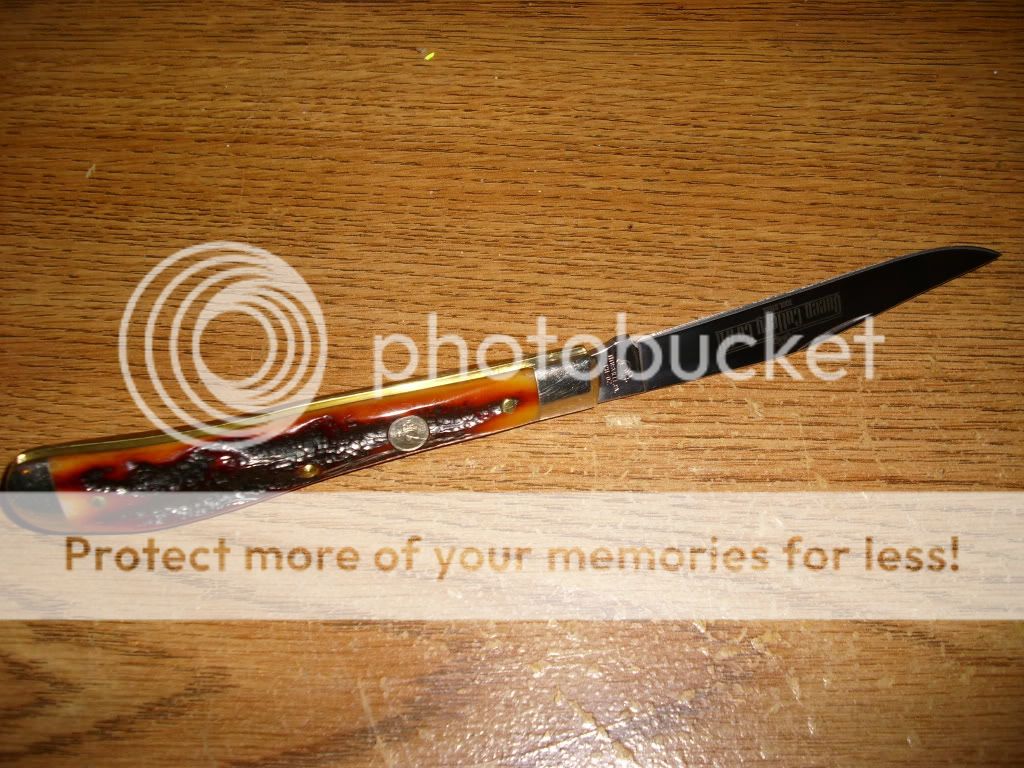

I've been working on the edge of Queen utility knife on & off for about 4 days & can NOT get this darn thing sharp!I've been using the sharp maker 30 degree(15 degree), AND I've been using the coarse diamond rods?!?I must've done hundreds of passes by now.What the heck number is this stuff hardened to?
This thing came as dull as a butter knife.
I've sharpened ZDP-189(same method),& it wasn't this hard to get a good edge.
I used the sharpie on the edge,to see what I'm removing(not much).I'm NOT pressing hard on the rods,so it isn't that.
What am I doing wrong?:confused:
Thanks for any help.
P.S. RichardJ,If I can't get a good edge on this,expect it in your mailbox soon;).I'd really rather learn myself though.

I just sharpened a 710 in D2 and had many problems with the ceramics. It was strange because I usually don't see this with D2 but the ceramics were chipping the edge. I had to switch to my sandpaper and lapping film to finish. From your pic it looks like you are having the same problem.

My Queens all came with really thick edges -- like about 50 degrees. Sharpmaker rods didn't come anywhere near the edge when I first treid it. I suspect that's what's happening to you. I thinned the blades using an extra course DMT -- to about 12 degrees per side. Finished with Sharpmaker followed by stropping. Upkeep is simple since I'm working with a microbevel.
Spyderco diamond rods are not very course -- something like 330 grit. Even 100 strokes may not have ground that wide shoulder down, especially if you're trying to do it at 30 degrees.
Anyway, confirm all of this with the Sharpie trick. Mark both edges with a Sharpie so they're good and black. Go back to the Sharpmaker and do about 10 strokes per side on the grey rods. You'll be able to see where the stone is hitting, edge or not.

I don't think you are likely to get a burr with D2. It is hard rather than ductile and a burr would tend to fall apart as it formed. The large hard carbides that make it wear resistant can make the edge break apart as you hone. That will happen if you use a comparatively coarse hone at a low honing angle. It may be that the diamond rod is just too coarse for this steel at 15 degrees. If that is the problem you might do better using them at 20 degrees (very lightly). In any case hone lightly alternating sides and ONLY USE THE FLATS OF THE RODS. The edges of the diamond rods are sure to demolish the edge.
I would start by painting the side of the edge with black marker ink (the Sharpee method) and hone carefully and see what is happening. Are you really getting all the way up to the edge? Is the basic problem the amount of work required to reprofile that obtuse factory edge? Is the edge being reached, but is breaking down. I like to finish an edge like this with an ultra-fine diamond bench hone. That seems to shape the carbides some without ripping them out. You might need to put on a 20-degree microbevel to be compatible with this D2. I don't have good luck doing this with just the ceramic rods. It might help to finish with a few strokes on a hard loaded strop. I like photographic paper with 1 micron diamond paste on top of a pad of paper. Softer stropping compounds don't seem to work as well on D2.

The main clip blades on my D2 stockman and whittler were both so thick behind the edge that I eventually gave up and thinned the blades on a belt sander. Once I got them down to 0.015" behind the bevel (from the original 0.065"), I didn't have any trouble getting them as sharp as I wanted. Before that, even when they were shaving sharp they didn't cut worth a damn.
