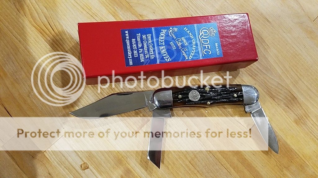

I just picked this railsplitter up off of the exchange, and I was thrilled with everything about it except the factory sharpening job. I was able to turn it into a razor on a Norton India stone without as much trouble as I was expecting. It sharpened up for me much more easily than I was led to believe based on how people talk about D2.
