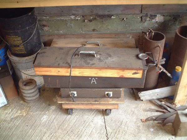

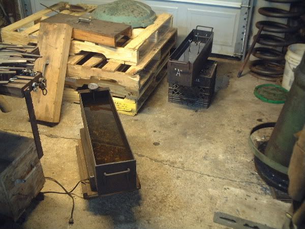

My tanks hold five gallons each of two different oils.
On whells to easily relocate.
Double burner to heat for each application.

Looks good, Karl. Thanks for the pics. I assume you quench edge down then?
I think the last questions are best for Kevin Cashen or someone who is more knowledgable to me. But I quench tip down, the entire knife. Temper at 450 for two hours twice. Then hit the spine with a torch.
Yes.
Early on, I could notice a slight difference between the hardness at the pointy end of the blade and the ricasso end.
As you enter the blade in, the blade heats up the oil, and maybe even starts to create a vapor zone between the blade and the oil. Just guessing here.
So, the last portion of the blade to enter the oil is entering an entirely different environment than the point did.
I understand that when I get into daggers and double edged blades I will need to use the vertical tube.
I think so many people use vertical quench tanks simply out of the simplicity and availability of tubes to use!
You can see the tube in my second photograph where I entered an air line to bubble and circulate the oil in an attempt to have the oil moving when I quenched. Don't know if it worked or not. But it did allow me to cool the oil off between blades.
