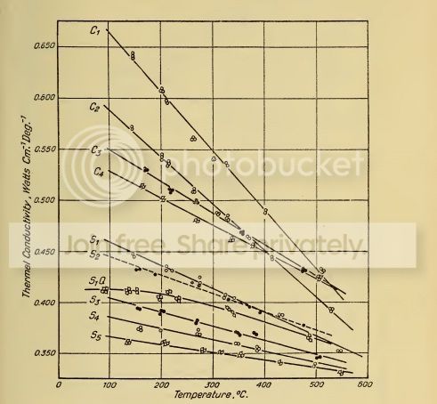

Thermal conductivity of metal does vary depending on temperature.

i need more info on that graph why is that a c and an s group and why do some cross over each other. the fact that we are talkig about pullig heat out of one piece os steel into another thing (be it AL CP or what evern and the makers varible od how much mass they have )
the auto temper issue is pushed off by frozen plates as they have more thermal loading possable before it sets in 2000f 1x10x.100 has a far different thermal load then a bar with 2000f 1x10x.5
your graph runs to 600c and notice how its pointing to a common point none of it has anything to do with as quenched temps. i am guessigng we also have a quenchant thickness on the left and most guys us plates at least 1 inch thick
.650 cm that is on the graph is close to .255 inch of plate
i stick to my heat can only travel so fast out of one thing and into a nother there is a bottle neck depending on what th4e4 thing to be quenched and wht is sucking tht heat out realistically yu can not bend science is steel can only dissipate heat at a set rate and copper c only soak it in at a set rate the temperature change is a mute point
