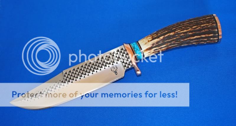

I've made a bunch of em....I ht to non-magnetic and edge quench in Brownells tough quench heated to 130 degrees. Temper twice at 375 and I'm good to go. Here's one:
