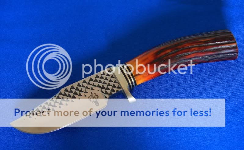

Loosearrow, Here is what the other side looks like, albeit on another of my knives. Fine teeth on the other side of the file contrasts well with the course.
