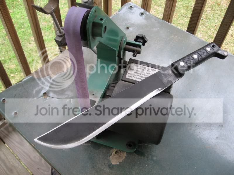

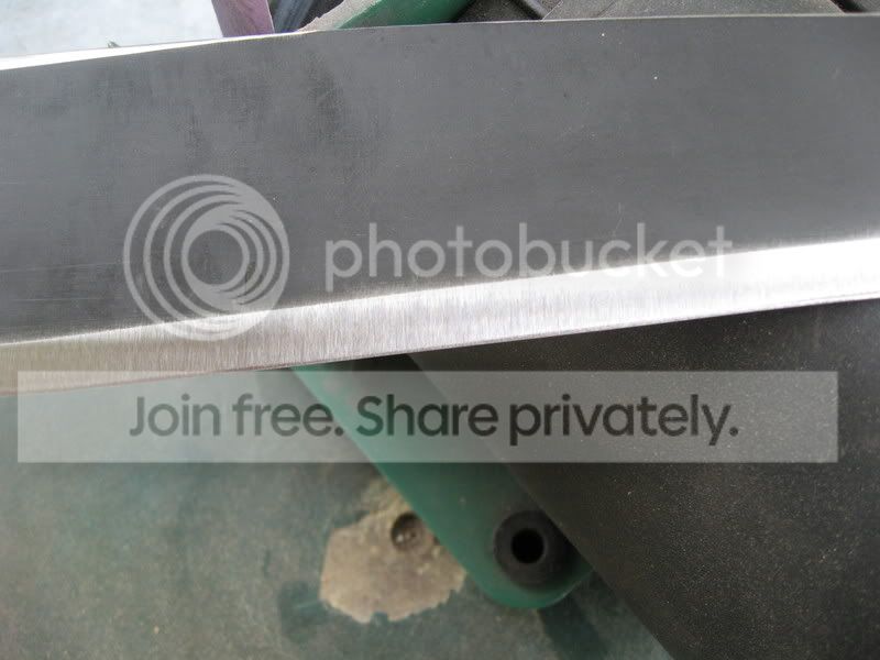

Here is the fast, easy way. Get a cheap 1" x 30" belt sander from Harbor Freight.
Once you have thinned the edge, it is easy to maintain with a steel, ceramic rod, diamond coated rod, or a file.

I've also got a 12" Tram machete, which came with a pretty sad edge. I just sat down with a bastard file for a while and thinned the edge a bit (kind of standard for me to do with any knife I'm unhappy with). I've used the belt sander idea too (using that same harbor freight model!) and it works well also. I like to keep the first 4 inches or so shaving sharp, and then a more chopping-suitable angle towards the front.

One thing to do w/ the machetes is to take the angled shoulder and round it, so you have a convex edge. It makes a big difference when you are cutting because the shoulder doesn't wedge in the cut.
