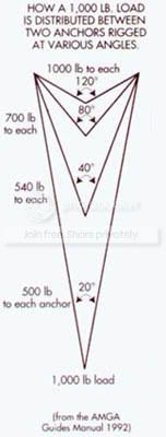

Here is a little exerpt about anchors.
Strong: Good anchor systems are built off of solid components, such as a good bolt, stout tree or immobile boulder.
Redundant: Anchor systems must be constructed of multiple components so that if any one component fails, the anchor will not fail.
Equalized: Building an anchor system so that the load is shared by all of the components decreases the chance that any one component will fail.
No Extension: If a component does fail, the anchor system should be constructed so that the remaining components are not shock loaded.
Using cord or webbing you can connect anchors together to equalize them and create redundancy, but also they are useful to adjust the length and position of the system so that the rope is not rubbing across the rock.
Intuitively you might think that two anchor points will split the load 50/50 in an anchor system. In fact, the geometry of the system determines how the load is distributed in an equalized system.
Consider the diagram at left. Of the four examples, which angle is will create the safest anchor?
When building an anchor system, how can you adjust the angle to ensure that you don't create an unsafe system?
