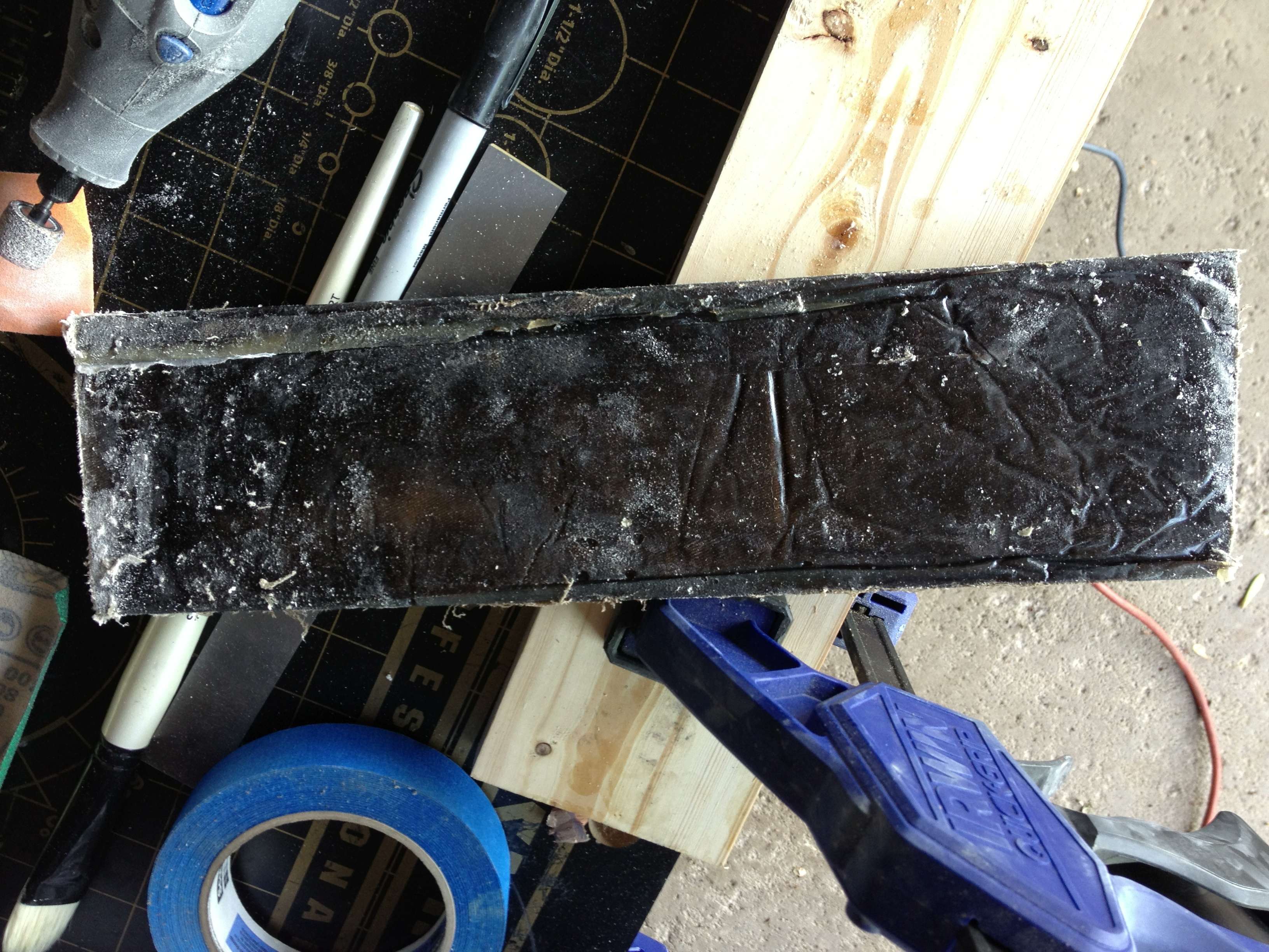

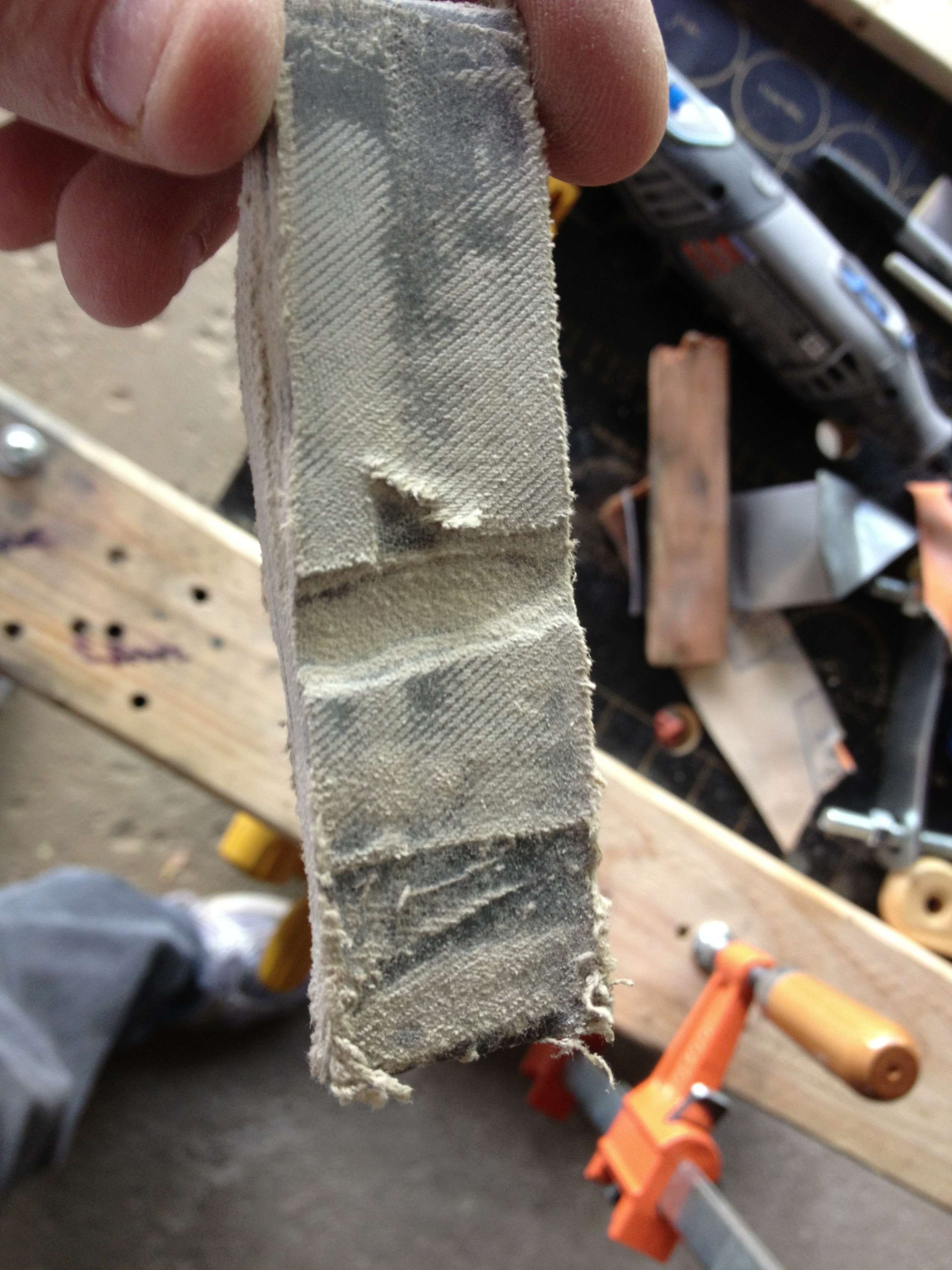

Ok, so I finally pulled the plug on this project, here are the results of the first failed "mycarta" batch.
Here's the sheet right out of the press...
The sheet was tacky on the exterior and very flexible bending to 45 degrees.
I cut off a small chunk to try sanding on with my Dremel and layers would peel away from time to time, so clearly it would not make a good medium for sculpting a handle.
Granted I failed but I will say that I learned a lot and will change quite a few aspects of the process in the future.
