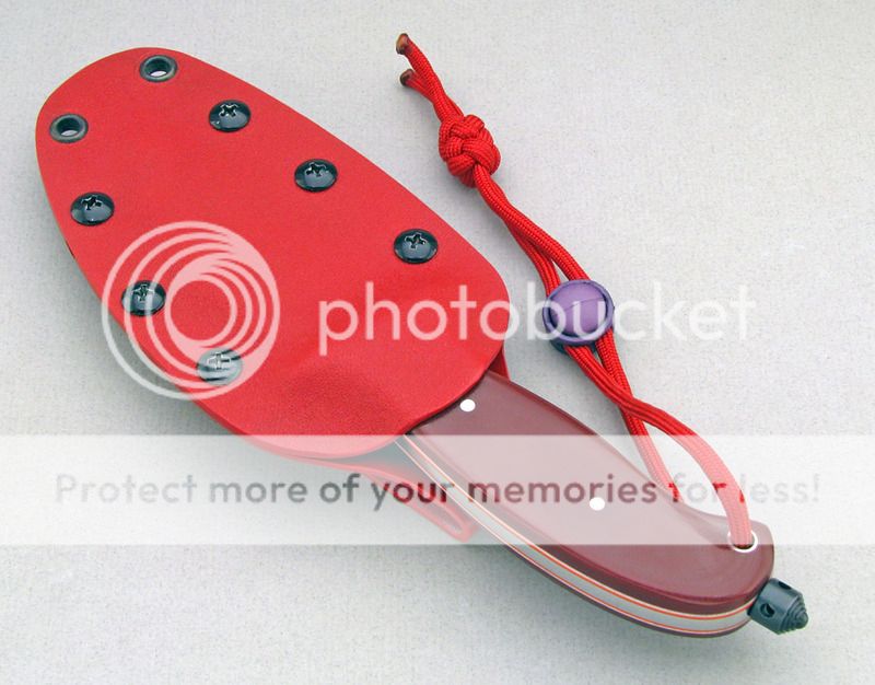

I built a kydex press and I've formed some kydex. This part looks good but prior to putting in eyelets I have a few questions about fine tuning. What I like about kydex is the ability of a knife to have a snap fit. So how do you fine tune the kydex to get the right amount of retention? I'm thinking you gradually carve off little bits of kydex until it fits right, plus you can adjust where the rivets go to control how the top of the sheath flexes. But how common is it to need to do a little adjustment to the shape at the top of the sheath using a heat gun?
It's probably pretty common. I used to do the adjustment thing you described, but I recently discovered that if I just keep my eyelets or screws below the leading edge of the handle, everything seems to fit fine by itself. Here are a few sheaths I made recently, which needed no fussing after they were joined with screws.
