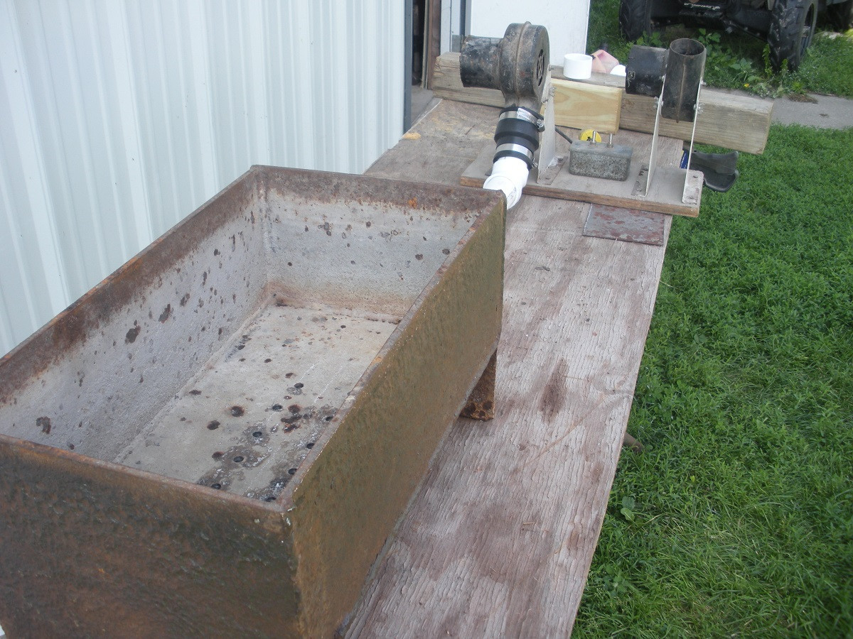

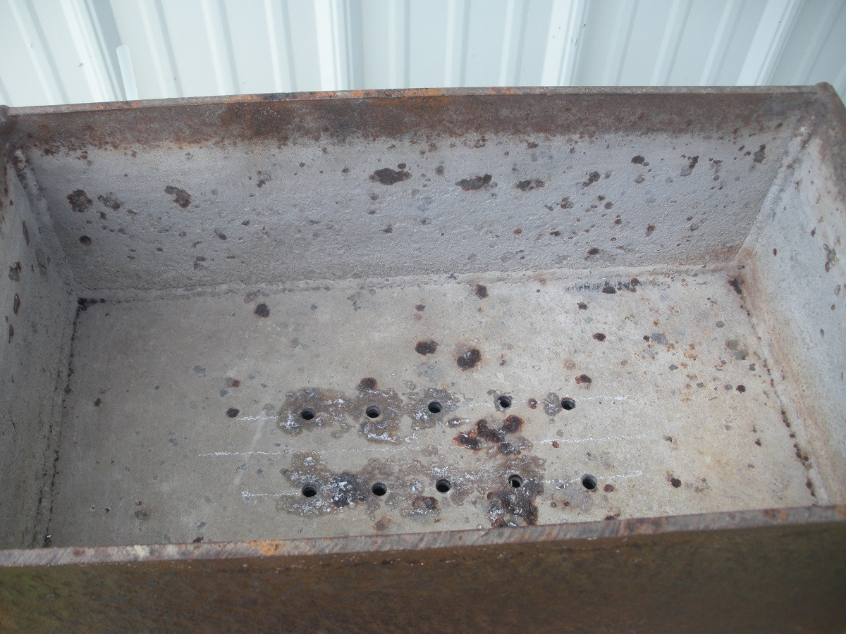

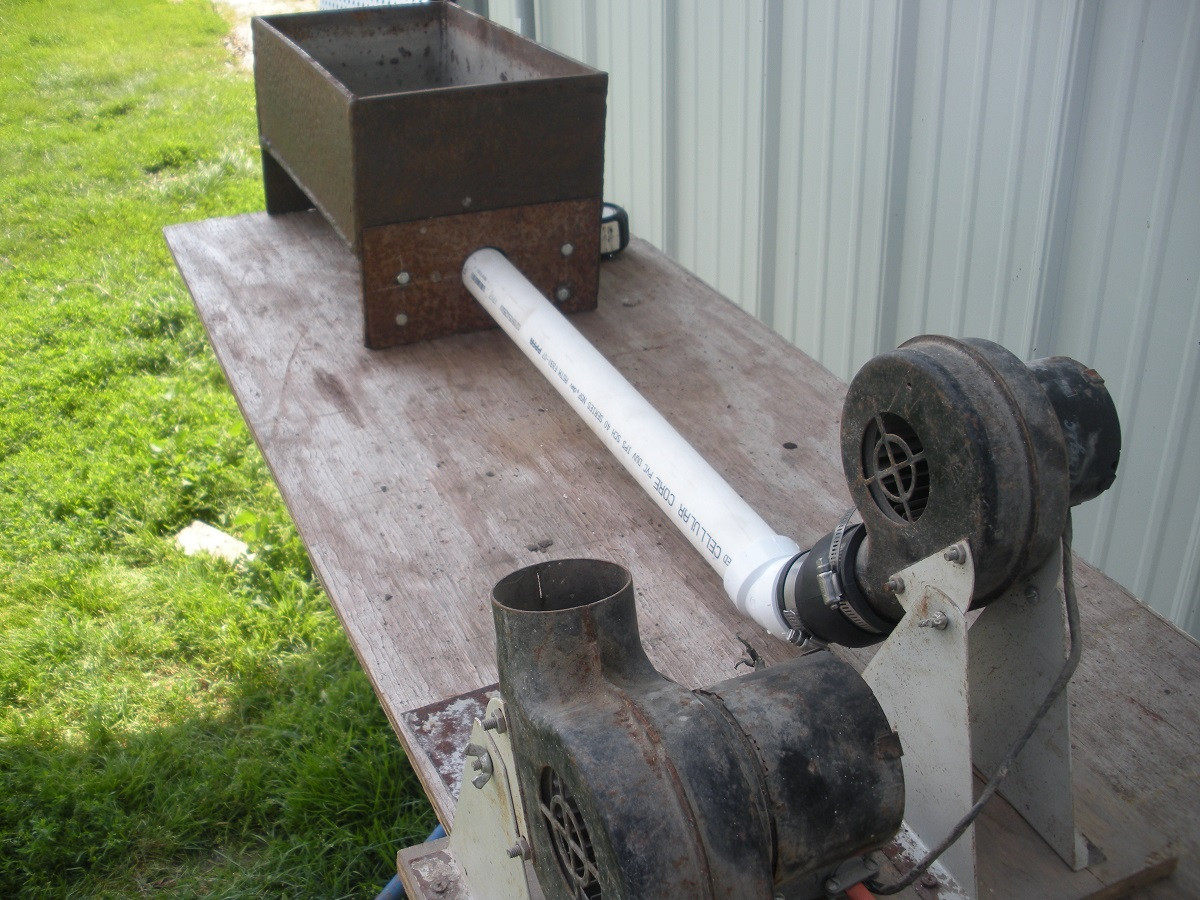

Thank you all for the information. Here is a few pictures of my set up. Any pointers?
I forgot to get a picture but this rig has a 3 inch wide channel that runs almost the entire length of the box welded underneath.
Well........., that will make a lot of heat, for sure. Unfortunately, PVC and heat don't mix well.
It needs a valve added to the PVC pipe up by the blower. use that to control the blast.
Without a tuyree, it will have other issues with ash, but that is for another discussion.
It will work for forging to some degree, but may be rather poor for HT. The problem is that you will end up with a big box of burning coals, not a controlled fire hole.
