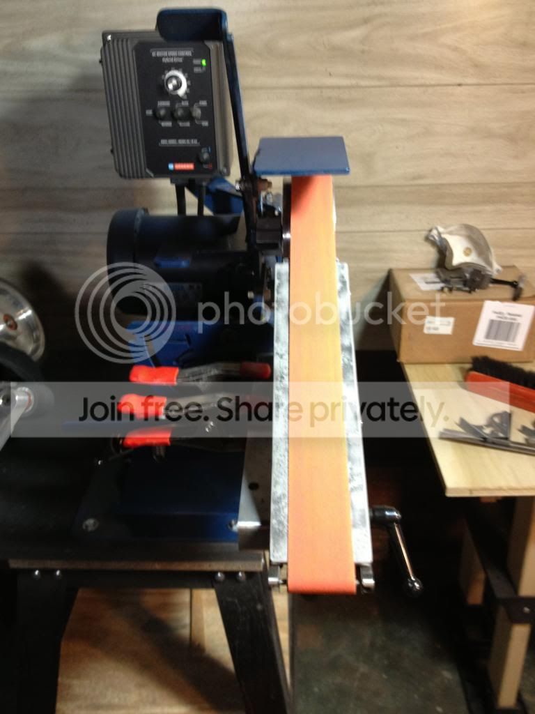

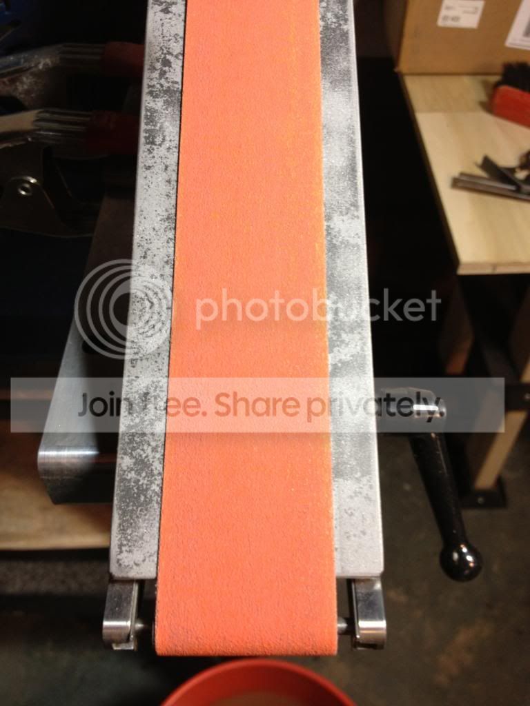

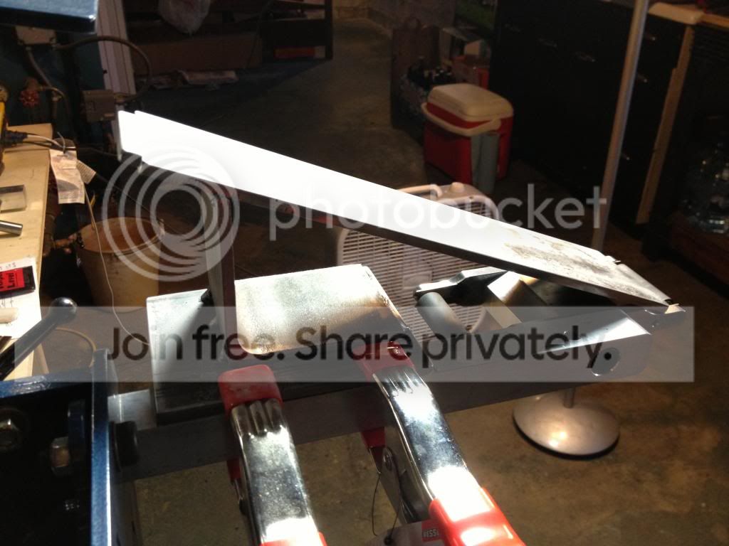

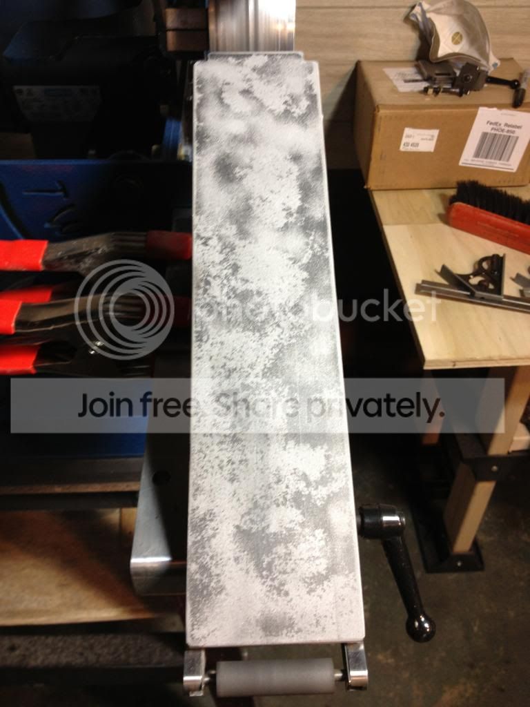

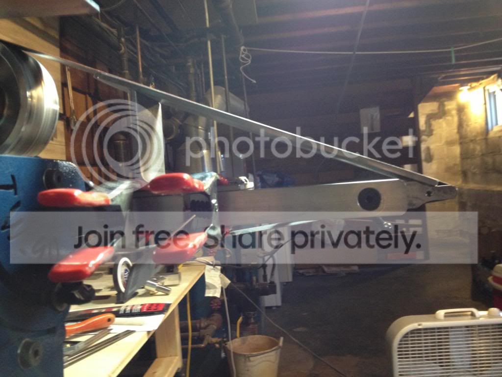

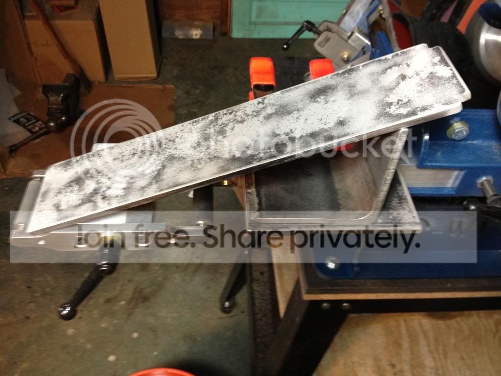

Well, thanks to Steve it looks like I got this thing 99% done, and perhaps quite a bit simpler than I first planned.
I'm usually the one to grind, cut, drill, hammer, whatever first, then regret it later. But I am really working on planning and layout and careful thinking these days. For whatever small discomfort there is in starting a project a bit later, there is a lot of satisfaction in doing it once and right.
So rather than drilling and tapping my tooling arm and/or milling slots in one or more parts of this fixture, I thought and drew and made cardboard models, etc. Taking my cues from Steve's page and post above, along with some very good advice from Tim Hancock on his grinding DVD, I wound up drilling no holes. I simply welded up a fixture like Steve's at the proper angles for my TW-90 and stopped. My thinking was that spring clamps might do the trick, and they do!
When I have more time tonight I'll post some pics and dimensions for anyone else who may be doing this. A very simple jig to make (believe me, if I can make it it's simple!) that increased an already versatile machine.

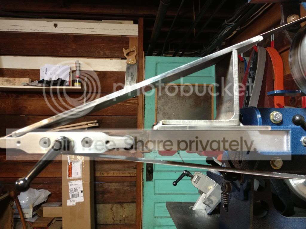

Here are the pics. Please don't mind the mottled look of the steel. I quickly sandblasted it for fun.
My platen is 3 inches wide by 14 inches long. The angle iron for the riser is 4" x 4". And the base plate is 4.5" wide by 5.75" long (I will soon be grinding the outside edge flush to 4.25"). The angle of the platen is about 24.5 degrees.
Looks like it will do the job! Will look forward to seeing some pictures of a blade ground on it. :)

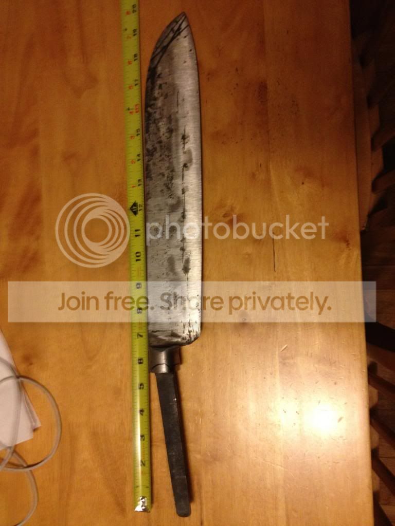

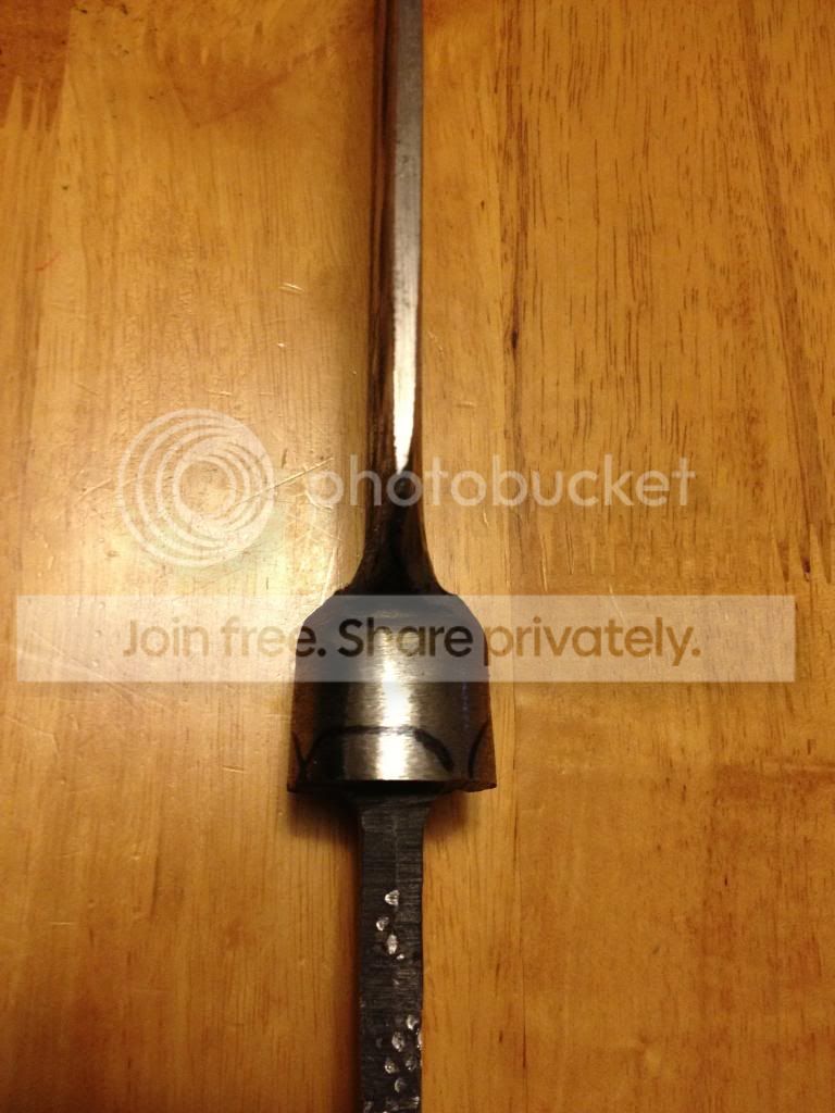

It was a trip to Burt Fosters a few years ago, followed by some time in SE Asia that got me on the idea of a big jungle type integral. Along came Don Hanson's 1.25" round W2 and voila! I now have a lot of bolster to clean up:)
