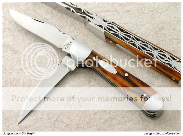

These Trappers made by Don Morrow don't get carried everyday. They have been carried and used though. I don't recall having any issues with lint or debris impeding performance. I would imagine if they were used for skinning that some extra care might be needed on cleanup.

Thanks for the comment. I've had both of these for many years. Don Morrow, if I remember correctly, was mentored by Bill Ruple.
