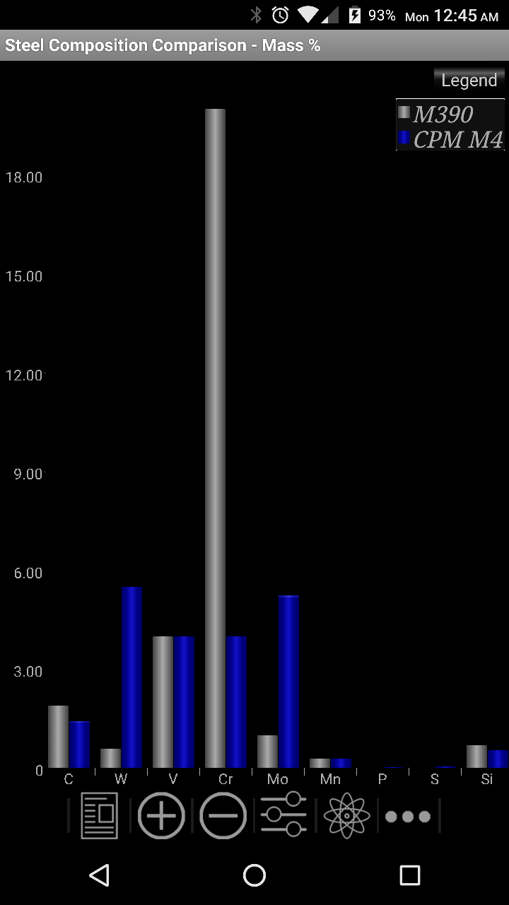

I'm trying to figure out whether m4 is indeed tougher than m390. The comparisons I'm seeing all focus on edge retention, with the two being equal or m390 coming out marginally ahead.
But is m4 tougher? Or is it roughly the same as m390, minus the high stain resistance?
Thanks!

Trying to pin down every variable in a scientific way could quickly spiral out of control, so I'll try to keep it as clean as possible: Let's say two Paramilitary 2 blades with a factory geometry, hardened to whatever the going production standard is for each.
Thank you for any insight!
Thanks so much, Slauterhause.
Is it the tungsten that makes you think so? The molybdenum?
I'm practically illiterate when it comes to metallurgy.
Exactly, at least that's the way I understand it. Since it's a wash with the vanadium, the increased tungsten and molyBD in the M4 would put it on top in the 'toughness' Dept.

M4 is tougher then m390
It's the lack of chromium that helps with that toughness
But it doesn't work like that across the board with every steel.
3v has 8% chromium and is tougher.
But that's due to a lower carbon content at 0.8%
So as a general rule the lower both the carbon and chromium the tougher the steel.
Of course they're exceptions
Also, the reason why the heat treatment is also huge is because the structures that are created in the steel with all those alloys are determined by heat and how long the steel is held at certain temperatures and quenched will ultimately determine how the structures are arranged thus performance or lack thereof

W,V,Mo are strong carbide formers so much ofit goes to formcarbides.
